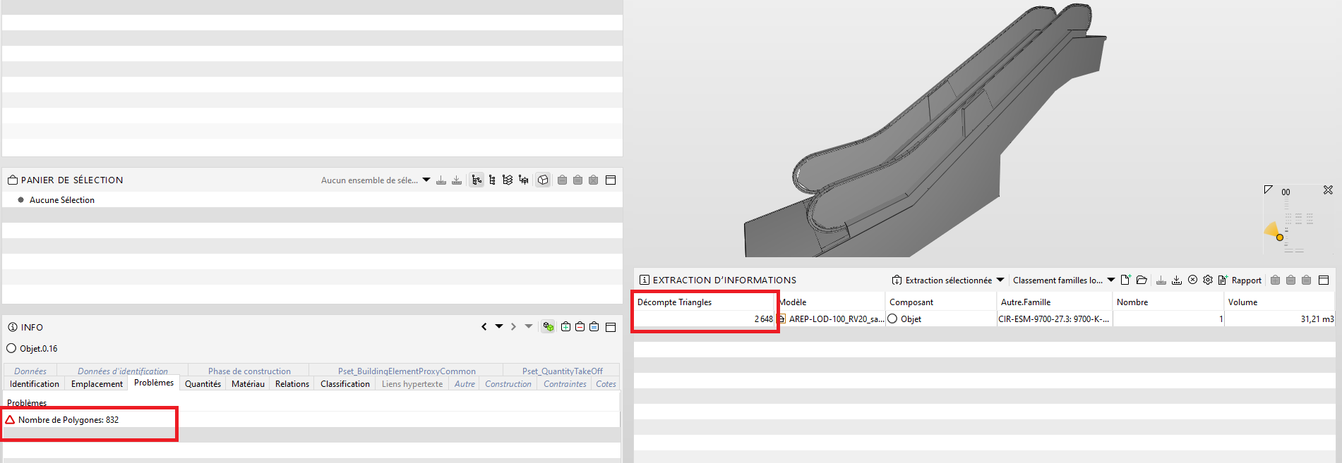

    I am noticing that the number of polygons calculated by the rule 176/2.2 is not equal to the number of polygons that you can see in an ITO.
    For instance, i have this escalator for which the number of polygons is 832 and the number of triangles is 2648.
    Why are these two numbers different ?
    Could it be possible to show the number of polygons in an ITO ?
    If not, is it possible to extract (to csv or excel) the number of polygons in any way ?

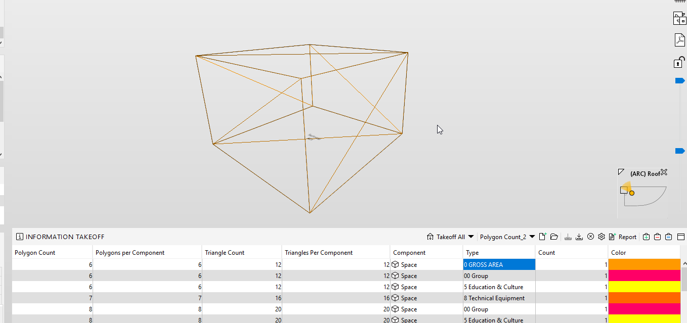

      The numbers differ as the polygon count reported in the Model Structure rule are the number of surfaces a component has. For example, a cube has 6 polygon surfaces for each side , but each side is made up of 2 triangles.
      I attached an ITO that has a javascript column that calculates the polygon count in the same way as the Model Structure rule. Just as the model structure rule works, it only performs the calculation for components that have BOUNDARY_REPRESENTATION geometry type. You can see the geometry type of a component in the Info View under Identification.Geometry. I hope this helps.
      Solibri Building - Maximum Poloygon Number.smc
      I’d recommend posting an enhancement for ITO to report number of surfaces(polygons) in addition to triangles.

        Ok, so my understanding is that the number of triangles is always greater than the number of polygons, since polygons are made up of one or several triangles.
        However, this is not the case for some objects. For instance, in the model you shared, I have this spaces which has . Why is that ?
        And in the same way, some objects have no polygons at all, only triangles.
        Which indicator would be best fit to calculate the global geometrical size of my model ?
