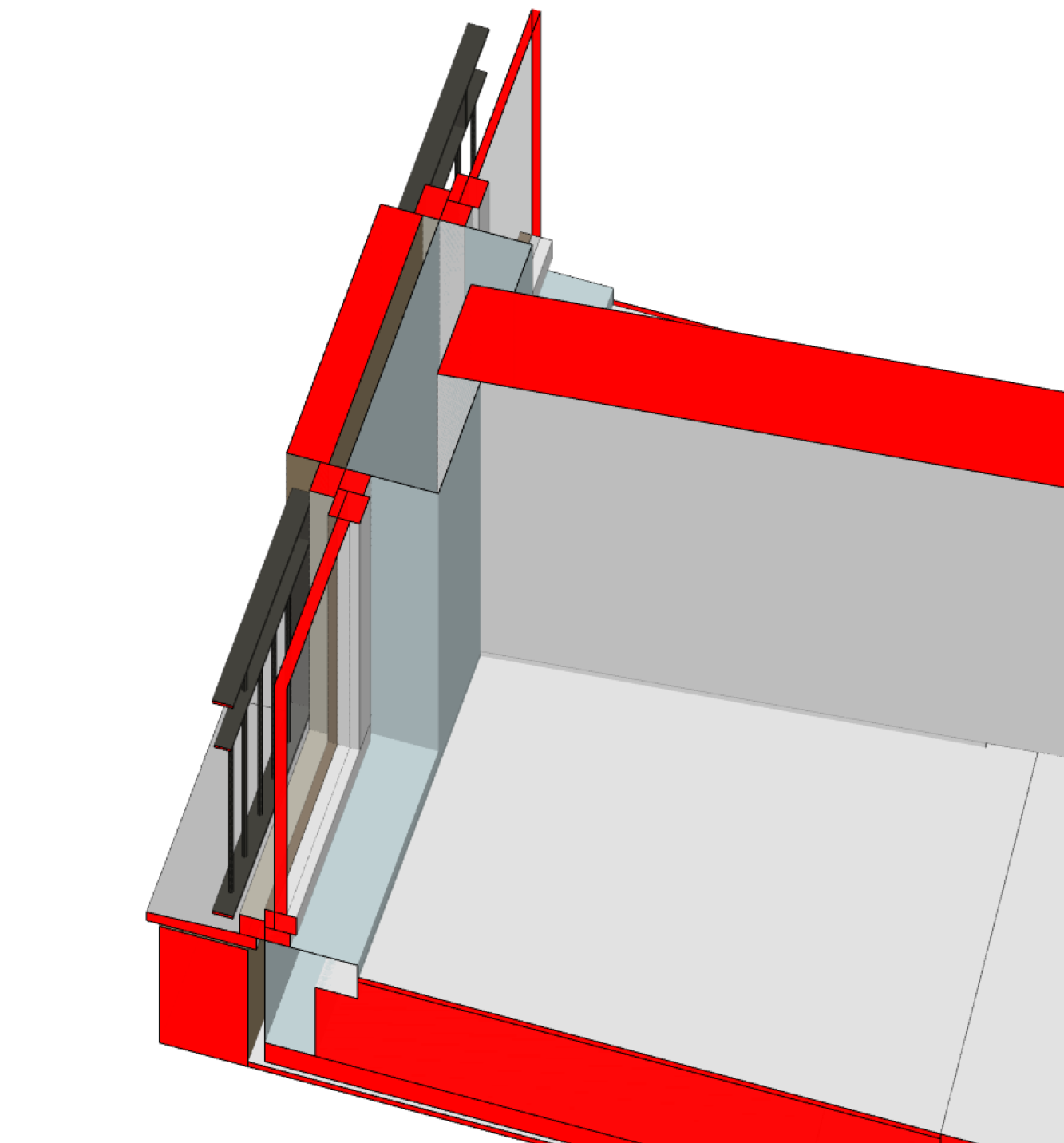

    I like the new functionality where elements have a color when I make a sectioning. However, some elements just don’t get a color.
    Anybody who has an idea why or when this happens? I have no clue…
    As an example i used red for the sectioning. The element that doesnt get coloring is a wall entity, just as the walls next to it.
    They are also in the same model.

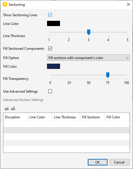

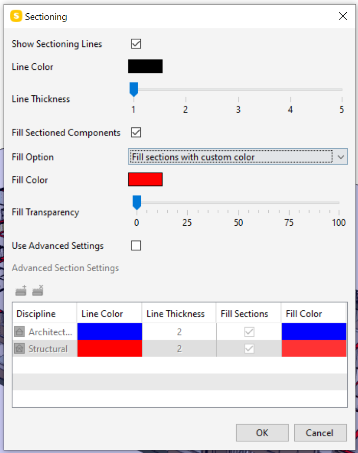

        @BIM1337 said in Fill sections with components/custom color not always working:
        What settings do you use? Can you post a screenshot?
        Here they are;
        B 1 Reply Last reply
        • B Offline
          B Offline
          BIM1337
          @Ricardo said in Fill sections with components/custom color not always working:
          Here they are;
          Strange I use this and don’t have your issue.

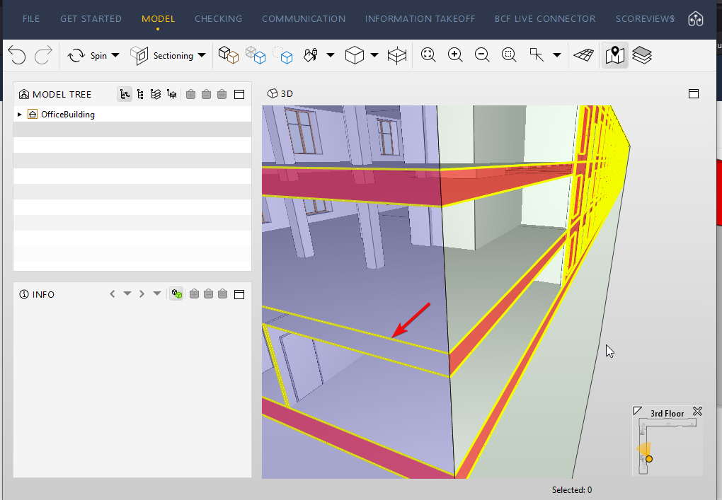

            @Ricardo
            I reproduced this with the officebuilding.ifc model that comes with Solibri:
            I’ve logged this issue with our R&D to investigate for a fix.
