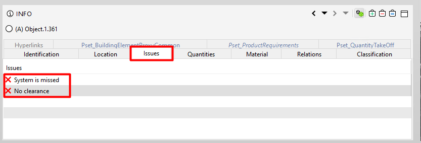

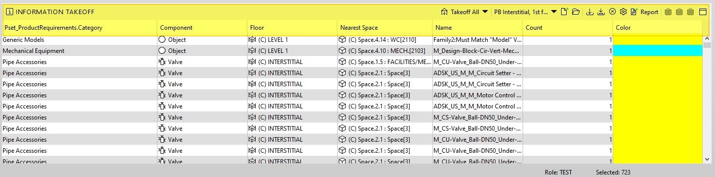

    Hi, everyone, i`m noobe in Solibri, just start learning. Could you help me please with next question : is it possible to combine that two kinds of reports TakeOff and Cheking. I need result - have all elements and if thay have some issues - see it in TakeOff. Is it possible to add Issue or Issue Description colomn to TakeOff report?Image 9.jpg

      Unfortunately no, out of the box you can’t take off the issue descriptions like shown in the info box. Why? I don’t know …

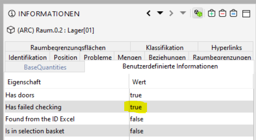

      However, what you can extract is the information if an element has any issues at all if you load the custom information examples. This could be used in an ITO but of course you still don’t know if the element has 1 or 999 issues and you can’t really limit it to certain checking routines.
      The custom info api examples used to be here but you can find them right now anymore.
      https://solibri.github.io/Developer-Platform/9.10.8/examples.html

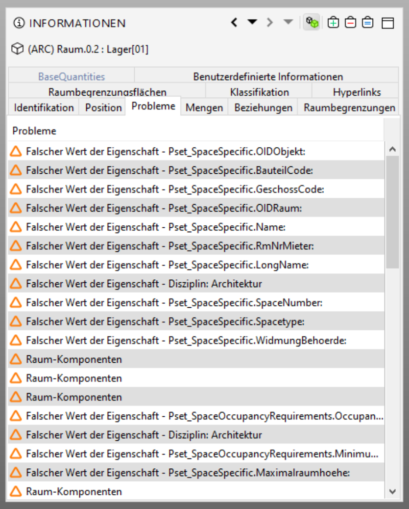

        But i still can’t take it to Takeoff anyway? Because issues of element i see without that script 2f68fc55-ef6a-4536-8fe7-540a270755ff-изображение.png

          Correct, afaik you can’t utilize the marked information of the Issue tab in an ITO.
