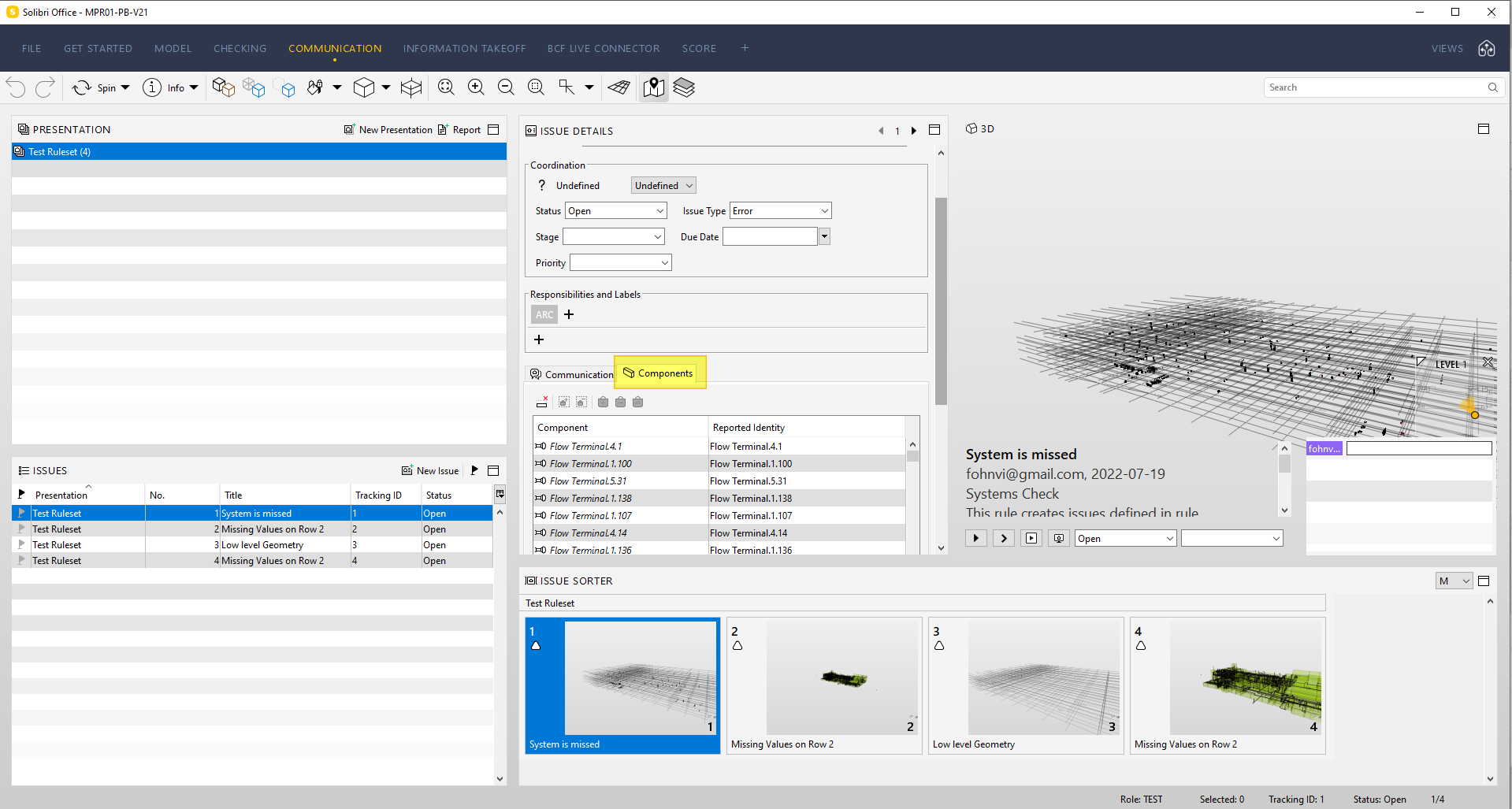

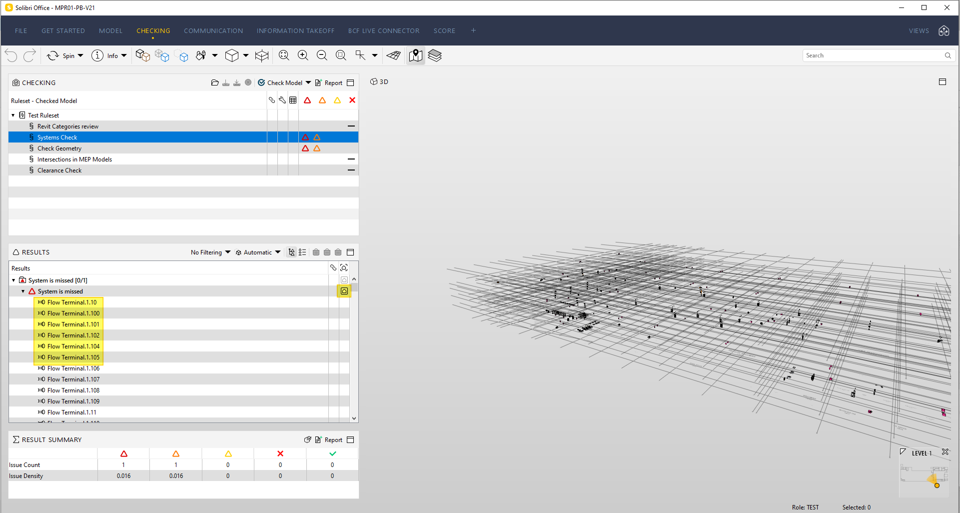

    Hi all. Does enyone know is it possible to make presentation with autorun for every element - becouse it akes no sence in revit - Autorun create only 4-5 issues with main rules and if i give this presentation in BCF to designers - they wuld see only general views with all that elements, it doesn`t convinient for them to correct that elements. When the model has a lot of elements with mistakes, it takes a lot of time to put snapshot for everyone. You can see this all elements in issue details, but in final BCF report - they are absent.
    P.S. I work with MEP models.

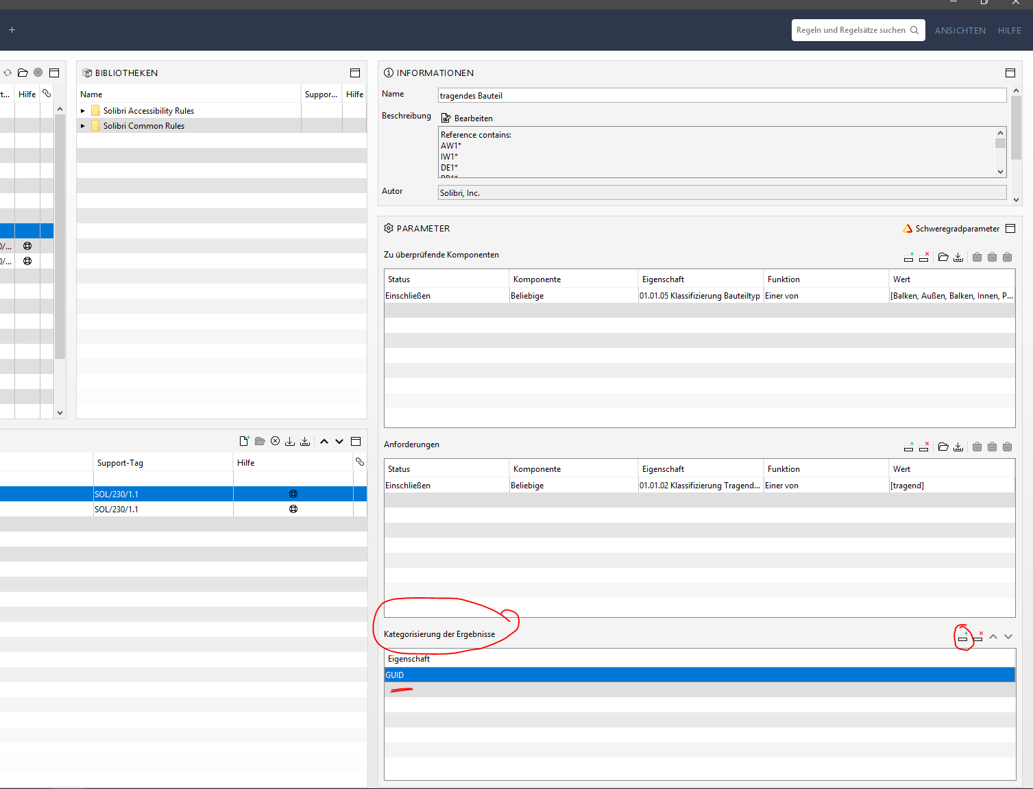

      Hi @Victoria-Volina ,
      you have two options as far as I know,
      first comes with each rule set, some of which give you the ability to categorize the issues.
      For example, SOL/230/1.1, if I use GUID as cathegory I would have each component as a single category issue.9ddce14e-5a57-4b80-80c8-25efc625b9e0-image.png
      Your second option is using Autorun “maxsnapshotsincategory”, please check out the Autorun Documentation
      assuming your ruleset categories are setup the way you want, you can set a high limit to the category to force autorun to generate a presentation slide on each issue.
      <autocomment zoom=“TRUE” maxsnapshotsincategory=“1000”/> would probably give you plenty
