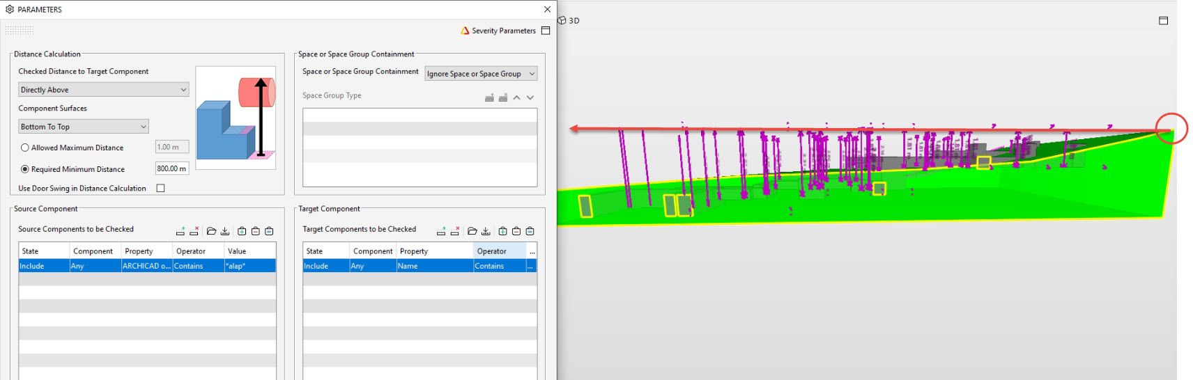

    I am testing component distance with a slope component and the rule seems only work between parallel surfaces.
    In the picture, I tested the distance of the top surface of the site compared to the bottom surface of the footing. It works fine with slabs, but the comparison counts only with the highest roof and mesh components point (indicated). (I also tried the opposit settings of Target and Source components, on translator side Parametric/BREP export).
    I see that measuring every slope point would not make sense, but is there any way to solve this issue?
    I guess it also issues in the case of checking slant pipes.
