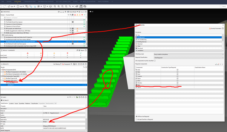

    I’m sure it’s a noob issue from me not understanding the preset rulesets. I have my Archicad stair and when I run the checking for necessary building elements (rule 11/4.1) Solibri can’t find any stair?

      The results mean that beams/columns don’t exist in any of your architectural models. Roofs/Stairs do exist, but they are missing their type info.
      If you scroll up in the info, you’ll most likely find the stair doesn’t have a type under Identification.
      If you only care about missing components, you can unmark the Construction Type Required box in the parameters.

        It’s just a test thing. I’m trying the out of the box templates to get inspired from them and maybe copy some good stuff.
