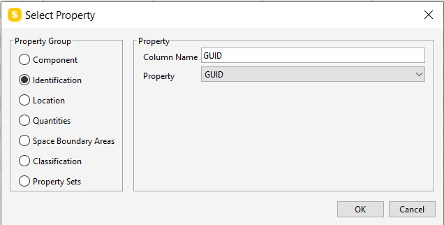

    I noticed when you use GUIDs in Classification, it can also pick an object that has the same GUID but with different case letters, thus it seems Classifications aren’t case sensitive.
    Is this a bug or a feature?

      It is true it uses case-insensitive comparison by default. So you had it with the GUID field?
      Maybe similar change to case-sensitive comparison should be done for BATID field, too.
      You could argue that all of them should be case-sensitive, but I don’t think that could be done if many people rely on the current behaviour.

        Case sensitivity can’t be added to certain items?
        I solve this now by using for example GUID and Type or sometimes more parameters in the Classification rules to make sure the correct objects are Classified.
        But it kind of defeats the purpose of having a GUID in Solibri I guess, since you’d want to be able to use just that instead.

            Yes to clarify: I would change GUID and BATID comparison to be case-sensitive and leave others as they are for backwards compatibility.

                    I have now added an internal task #8920 about starting to use case-sensitive comparison for BATID and GUID properties in classification rules.

                              @JeroenKoomen This is trivial to fix. The fix will be in the next release. Thanks for reminding.

                                  We have just released beta version of Solibri 24.9 which contains this fix. If you would like to test that out before release and provide any feedback that would be great. Instructions on how to join beta program are included in the release post:
