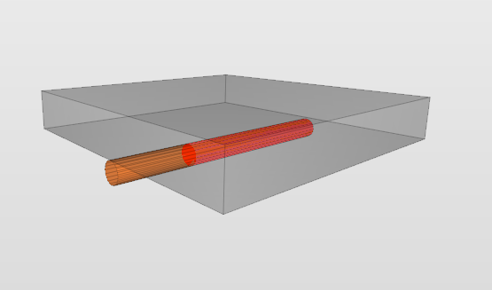

    …and make the rest transparent in one colour? Rule checkining in all its glory but visual check can be a very good alternative and highlighting the volume where models/component clash would be helpful. Is it possible?

      Hi @Mats_Knutsson
      You can use the intersections of the TriangleMesh of the components that clash. I modified the example https://solibri.github.io/Developer-Platform/9.12.9/clashDetectionExample.html with the following:
      .withVisualization(visualization -> {
        visualization.addComponent(source, transparency);
        visualization.addComponent(target, transparency);
        ARGBColor intersectionColor = ARGBColor.create(255, 0, 0, 255);
        TriangleMesh intersectionMesh = source.getTriangleMesh().intersection(target.getTriangleMesh());
        visualization.addVisualizationItem(Mesh.create(intersectionColor, intersectionMesh.toTriangleCollection()));
      Results in the following visualizations:
