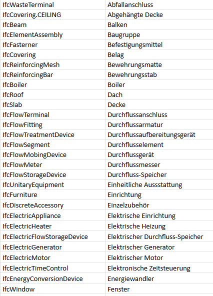

        • StephanLiedtkeS Offline
          StephanLiedtke
          wrote on last edited by StephanLiedtke
          Dear Ilona,
          do you think of something like the following? (sorry its in German):
          With the following link I share the excel sheet with you. It should at least fit to the Solibri labels (Link).
          https://www.bitsandbricks.solutions
          https://de.linkedin.com/in/liedtkestephan
          • I Offline
            I Offline
            Ilona C.T.
            Dear Stephan!
            Yes, I need a list like that, including all the possible IfcEntity and Component mapping. Thank you very much for sharing it!
            I am going to share the English version as soon as I get there. 🙂
            Ilona
