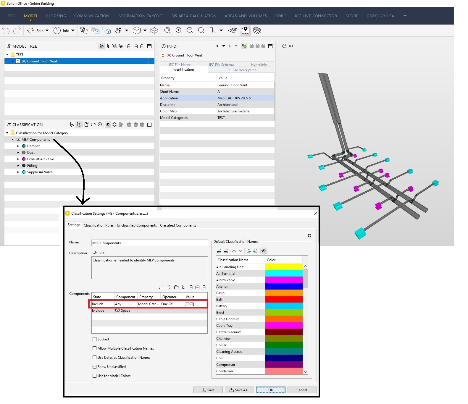

    HI @Solibrians,
    I noticed a classification anomaly when it is linked to a model category. Did it happen to you too?
    Here the steps I followed:
    1- I have added an ifc model and I have associated it with the model category called “Test”; then I created a classification that takes only the components contained in the Model Category defined before.
    See image below:

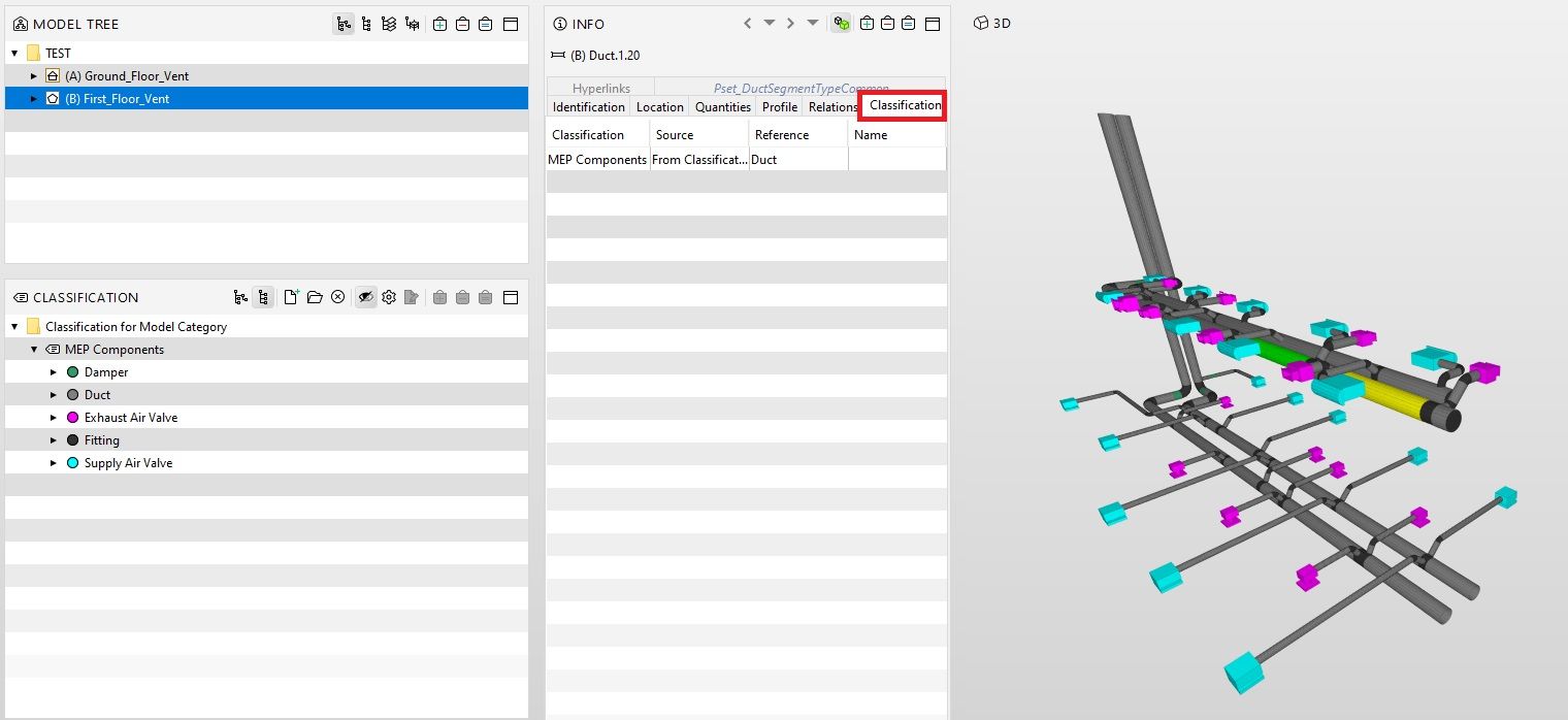

    2- I have added a second ifc model to the Model Category. I would have expected that the classification would automatically update correctly but it did not happen. All new items are not classified.
    See image below:

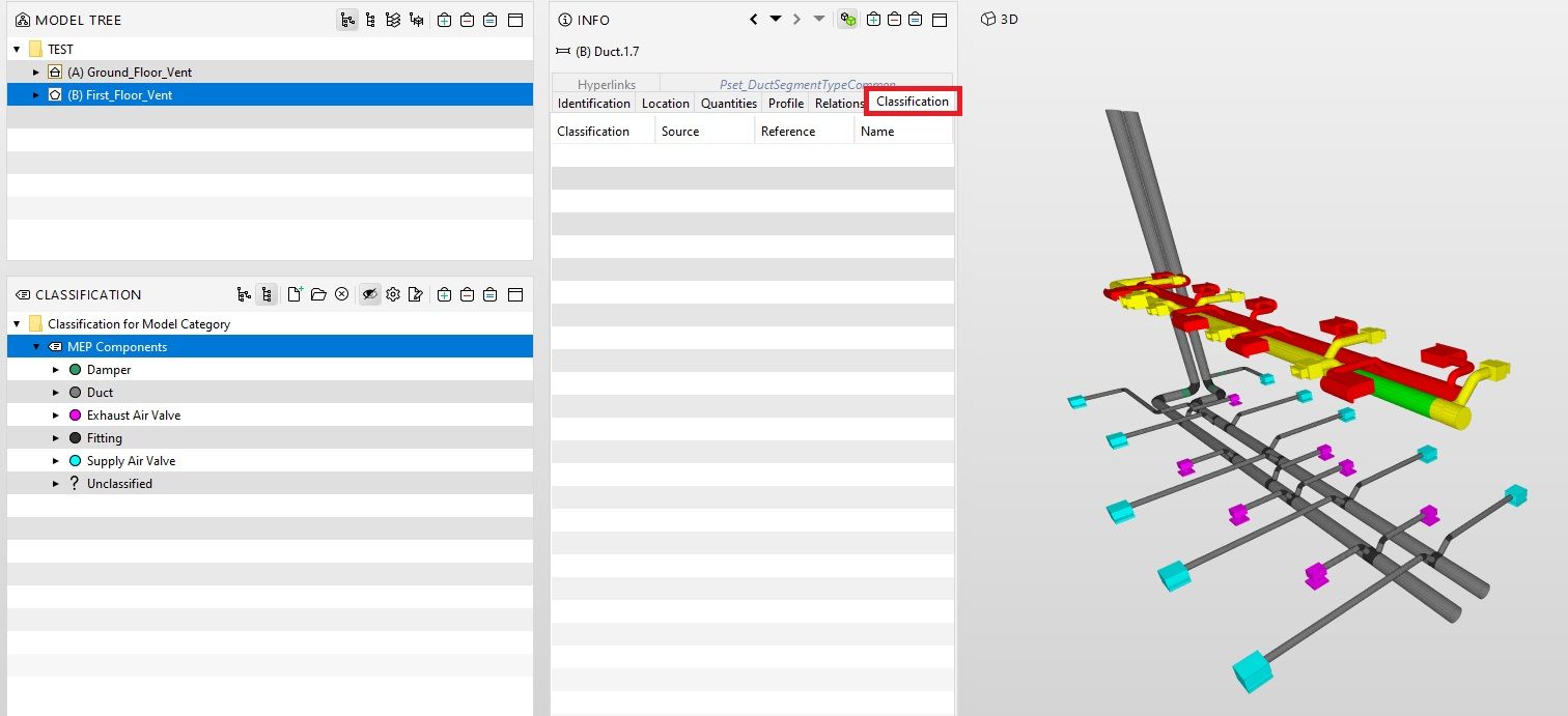

    3- Only if the classification is closed and reloaded then the correct classification results are obtained.
    See image below:

      Hi. Classifications are only recalculated on specific times, one of which is the acceptance of the classification dialog. Some others are IFC updates/imports.
      There are so many things that classifications can rely on (including current time) that this is a difficult problem to solve. Of course in this specific case we could force recalculation when model category is used somehow and they are modified.
