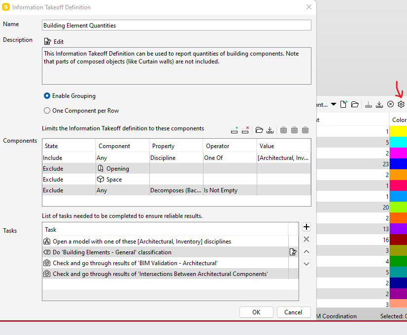

    • How do I differentiate between specifying and search to add when I filter components in the information ITO definition?

      @Jeff-HBO said in Just starting with Solibri, got some Q's about ITO's:
      Can you elaborate this?
      Is it possible to find matches between info of elements to know which things to select in your info ITO definition filter?
      You can specify which components are considered in the ITO in the filter that you can find when you press the “Edit Information Takeoff Definition” button (the cogwheel) in the toolbar.
      Above the filter you again have the buttons to add/remove/set components to the selection basket. With those, you can see which components the filter affects to. Unfortunately, those buttons seem to be disabled at times.
