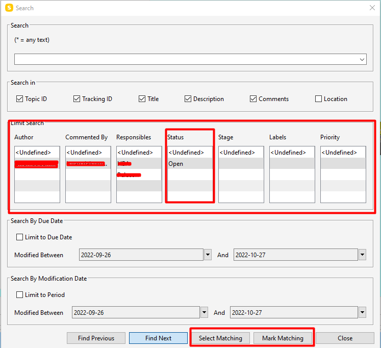

    Hi, I am looking for a way to filter the issues that are not yet solved so that I don’t see all issues that are already accepted.

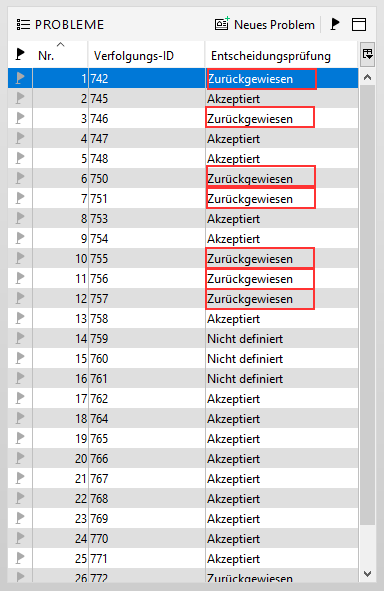

      You can use “search” in the presentation view (right klick, search ore ctrl-F).
      select “Zurückgewiesen” and use Select Matching ore Mark Matching.
      If you use Mark Matching you can filter the marked items with the little black flag

        Thank you @BvanDalsum
        That’s very helpful.
