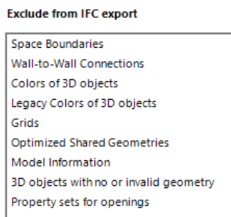

                  @Jimin
                  Yes, but in a different way. For example you can optimize the model by leaving out unnecessary information in the export;
                  There are also standard scripts that will let you remove assemblies, double elements etc. However with most problematic IFC’s it’s just a matter of re-exporting (for me) to make them work. Also the size gets smaller for me most of the time by doing that.
