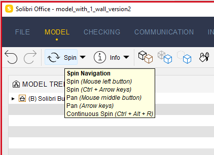

      Pasi Paasiala Solibrians
      The shortcut to turn is Ctrl+Alt+R:

              For me there is a difference when using left or right ALT.
              Left ALT+R hides the roofs.
              Rigth ALT (GR) + R auto rorates the model.
              It seems like on my system the right ALT is actually firing CTRL + ALT.
