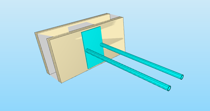

    I would need some advice / help for the following thing I want to achieve in Solibri.
    In the screenshot below you can see several collisions:
    • Collision 1: “recess / partitioning wall”
    • Collision 2: “recess / piping”
    • Collision 3: “piping / partitioning wall”
    What i want to achieve is a nested rule, which should work like the following:
    • Rule:
      Are there collisions between the modell for the recess and the piping
    –> At any place where there is no collision the next (nested) rule should check:
    • Nested Rule:
      For those pipes where there is no collision with a recess… is there a collision with the architectural model
    Perhaps someone could get me some advice how to get there. I tried serveral things with the SOL1 but it won’t work…
