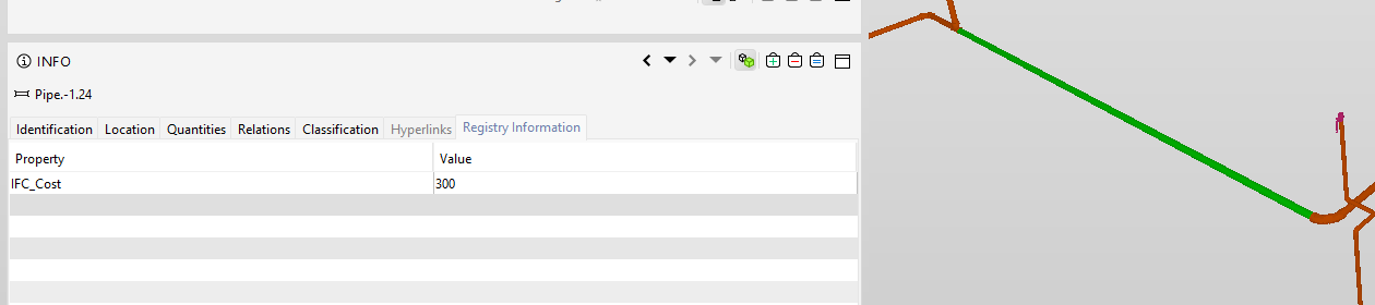

    I am investigating on how i can do a cost estimate using solibri.
    I tried to export an IFC model which has the cost parameter in each of the element. However, i cant export these parameters in particular.
    Is there a way to export the quantity and cost? Any other workflows related to 5D BIM and Quantity Take offs in solibri are welcomed.
    Thanks a lot!

        I created a simple ITO that might work:
        Cost Estimate.zip
        Do the following:
        • Unzip the attached file
        • Open your model
        • Open the attached file in Information Takeoff
