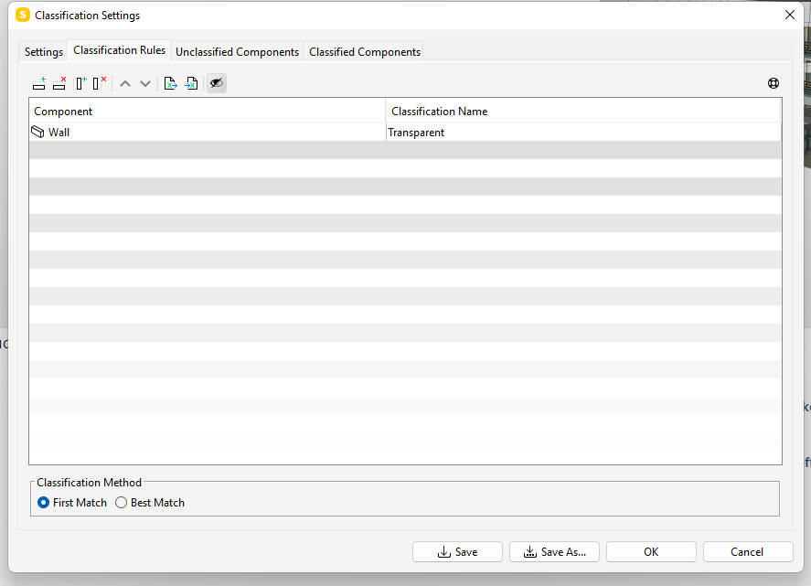

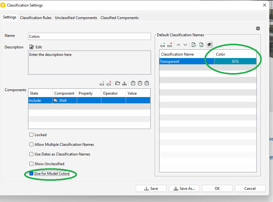

      @Geir
      In Solibri you can make a classification that overrides some colors:
      https://help.solibri.com/hc/en-us/articles/1500003953721-Using-Classification-Colors-for-Model-Visualization

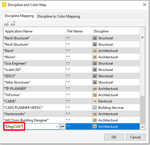

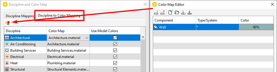

        • BvanDalsumB Offline
          BvanDalsumB Offline
          BvanDalsum
          @Geir you can manage colors using Color mapping.
          in settings.
          add youre Application to the list (MagiCAD), you can fill in a Filename or use a wildcard
          then you can edit the color map for instance “Architectural” .
          add the components you want to color and save the file for future use.
