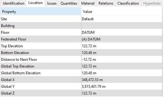

    After I run the Model Revisions Comparison - Architecture -> Component Comparison, some objects show up with the following results:
    (A) Object.-1.10 has following modifications compared to (B) Object.-1.53: - Geometry is changed Location: (B) DATUM, (A) DATUM
    Is there a way to see what has changed? From visual inspection, the geometry has not changed and Quantities and Location are the same for the original and the revised object:
    Thank you
    Giovanni

        Hi Pasi,
        Thank you for your reply to my post. I cannot upload the files on the forum but I can send an extract via email.
        I have found a small difference in the Project Base Point between the old and the new IFC files. Would this be taken into account when running the checks?
        #113=IFCCARTESIANPOINT((348400000.,5815300001.,-2.4567640817928363E-09));
        #111=IFCCARTESIANPOINT((348400000.,5815300001.,0.));
        Is there a way to set the tolerance when running the check?
