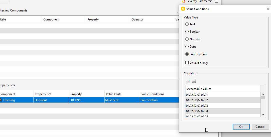

    I am trying on SOL/203/2.4 - here I can check that a value must exist and import an excel sheet. My issue is the import itself, it does not exclude empty rows and all imports come in as enumerations, no matter how I change the import.

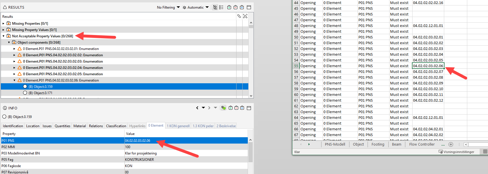

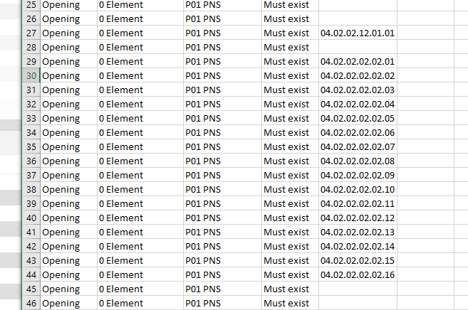

    I have an excel-sheet with a bunch of values, see picture below:
    This is just a screenshot, the list is far bigger. Anyways, the values all the way to the right from this list, are the only ones allowed in the model. When I import them, however I try to, I get this:
    They all come up as Enumeration and as such, when I run the ruleset, it fails to recognize all values that actually are correct.

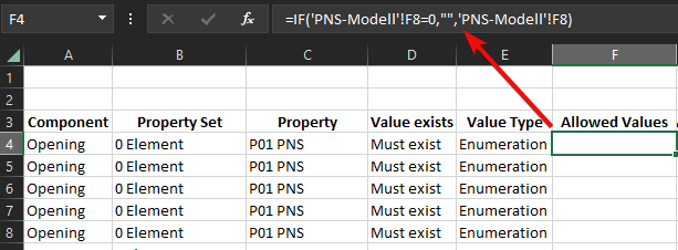

          Another problem I see is that the rows values in the openings sheet are being pulled from the PNS-Model sheet, so you need to somehow concatenate those rows into a single cell for Solibri.
          In the formula, I see that it places a " " space if a value doesn’t exist. However, the TEXTJOIN function in excel that you can use to concatenate these ignores a cell only if it is blank, so you would need to change the formula as such:
          example: =IF(‘PNS-Modell’!F8=0,“”,‘PNS-Modell’!F8)

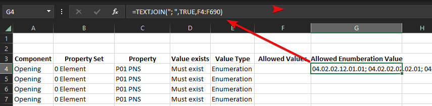

          Then at the top you can add =TEXTJOIN("; ",TRUE,F4:F690) to the next column to concatinate those rows with a semicolon delimiter.

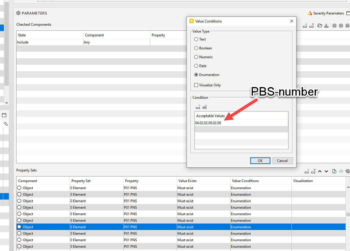

          That will then allow you to import that single row into the rule using the exel:
          You’ll then have them all listed in the value condition: 8aa52daf-0c3a-4697-9c00-5d5d4bba167f-image.png
