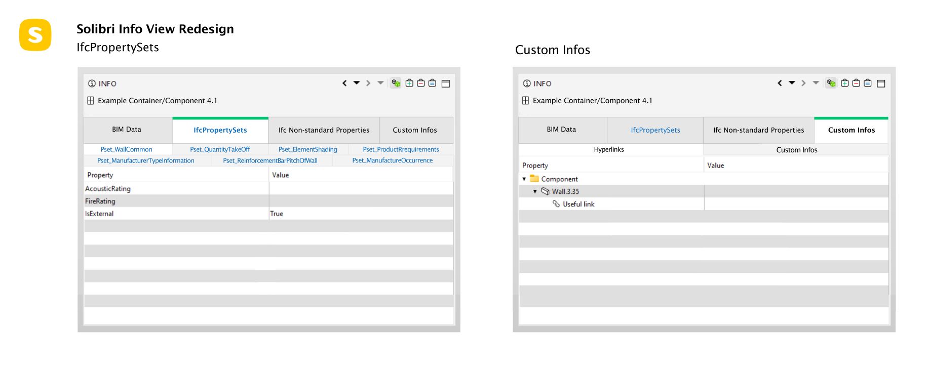

    Dear Society members and Solibrians,
    We would like to share with you an upcoming improvement on restructuring Solibri Desktop’s Info view, it is an effort we made to deliver you a better experience when viewing models’ information.
    The changes include:
    1. New info categories. All info tabs are organized into 4 main categorized tabs: BIM Data, IfcPropertySets, Non-standard Properties, Custom Infos
    2. New container/component property categories: --Identification has 5 new categories: Model Attributes, Solibri Data, Information CAD, Component Attributes, Ifc information. --Location has 4 categories: Hierarchy, Height, Coordination, Nearest Spaces. --Quantities has 2 categories: Quantity Component, Bounding Box Component.
    3. New Accordion UI: you will be able to expand or collapse the property categories to easily view and find the info you need.
    4. New order for the properties: In addition to categories, the properties also has a new order!
    Below you can find example images of the said improvements and find the new categories:
    Do you like the new order or do you have any suggestions for changes? And what about the categories? Are these appealing to you or do you have suggestions for changes here as well?
    We would like to hear your feedback on this, please let us know by leaving a comment below.
    P.S. If you want to elaborate an even more specific suggestion please DM or email Cecilia.
    Paul & Cecilia on behalf of Solibri Team

      Love it ! 👍
        Will Custom Infos still be mixed up all in one tab? Will they be sorted or grouped in any way?
        Paul LinderP 1 Reply Last reply

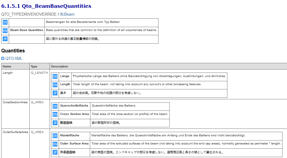

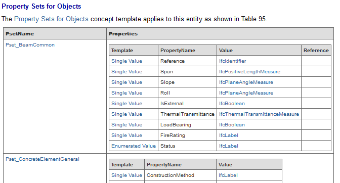

          I think it is a fantastic step in the right direction. When I go over Ifc data (usually IFC4+ because it is just documented better), I try to categorize my data as close to the info pages on BuildingSmart as possible.
          Every Entity has its own Attributes, and a bunch of Inherited Attributes. The numbered attributes are the ones you would want to see. A dedicated place on the BIM data tab would be great, but I still see some Attributes I would rather place elsewhere. For instance: Firerating, Predefined Type and Operation are either Propertyset Parameters or Attributes and I would not place them under “Ifc Information”.
          There are also some translations, like GUID instead of GlobalId (but now I’m just nitpicking).
          If possible, I think we should stick as close as possible to the names used by BuildingSmart. But I am curious what other people think.
          The Entity in turn has Property Sets (Pset) and Quantity Sets (Qto). Again, both sticking as close as possible to the BuildingSmart naming.

              in this draft it is still mixed. There is only a distinction between custom info (API) and hyperlinks. Do you have any suggestions on how this should be categorised from your point of view?

                I agree with @b-huijskes. The closer we get to placement and terminology to the standard, the easier it is to implement, give feedback, teach etc.

                  I also agree with both @b-huijskes and @tsolsen. Overall I think the information is presented a lot clearer. Will it be possible to open/close all paragraphs at ones?
                      Something small but I think is important for the user experience; when you cycle through the tabs of information, the open/closed paragraphs should retain their position. At the top/bottom of the view I would add a ‘collapse all’ or ‘open all’ button.
                      Overall, I like the new view, it looks cleaner. I agree with the abovementioned replies about sticking close to the BuildingSmart standard.
                      If I may add, maybe not about the restructure but more of a request; a ‘select similar’ option for information in a right click menu. And in theory that could be made more powerfull with options like ‘make ITO based on this parameter’.
                        @Ricardo said in We’d love to have your feedback on Info view restructure:
                        Definitely - it’s for sure cleaner but also brings a lot of more clicking with it and therefore collapsed/expanded status should be remembered. Just thinking out loud, but probably even a small search bar to filter within one element would make sense. Best case with the same behaviour, so if I type e.g. “Floor” and click on several elements to quickly check the searched information on those the should stay on that focus.

                            I agree too about sticking close to BuildingSmart standard.

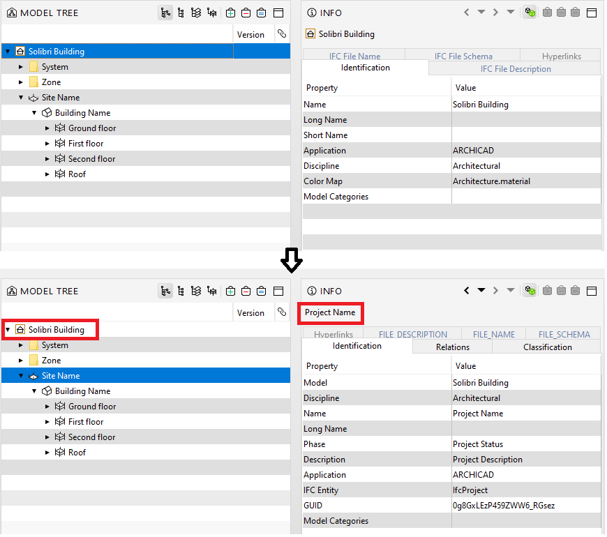

                            I would also like to add another request on the Info View: the possibility of directly reading the parameters of the IfcProject entity (now this entity must be retrieved from the IfcSite Relations).

                                I agree with everything said (sticking the closest to bS terminology would be best, IfcQtoSets should have their own tab, selecting elements with same property value, seeing IfcProject in the hierarchy).
