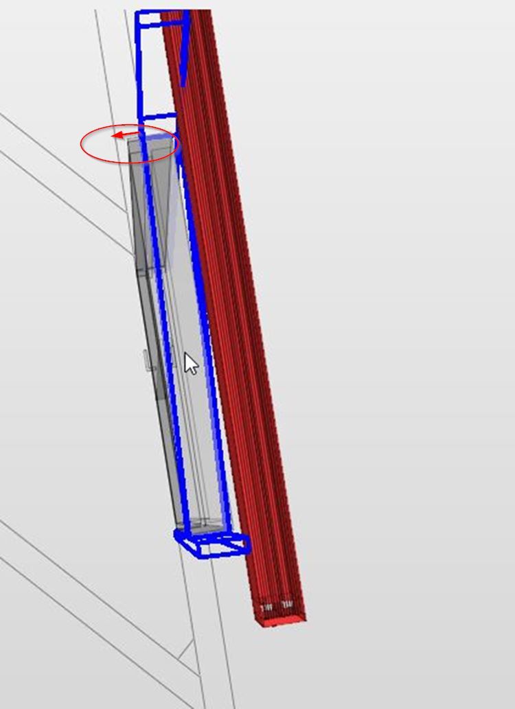

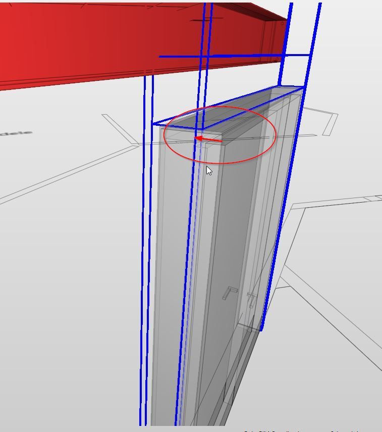

    i have been testing the “stud opening ruleset” but it looks like the result is slightly rotated in relation to the door, has anyone else experienced this, and how did you fix it!

      Hi, Please respond to email from Solibri Support. We will look into this issue for you.
        simon.gilbert Solibrians
        This should be resolved in the latest build of the Fire Stopping rules, the issue is related to components distance from the origin. We now transform the Door to the origin create the studs and re-position to carry out the clash.
