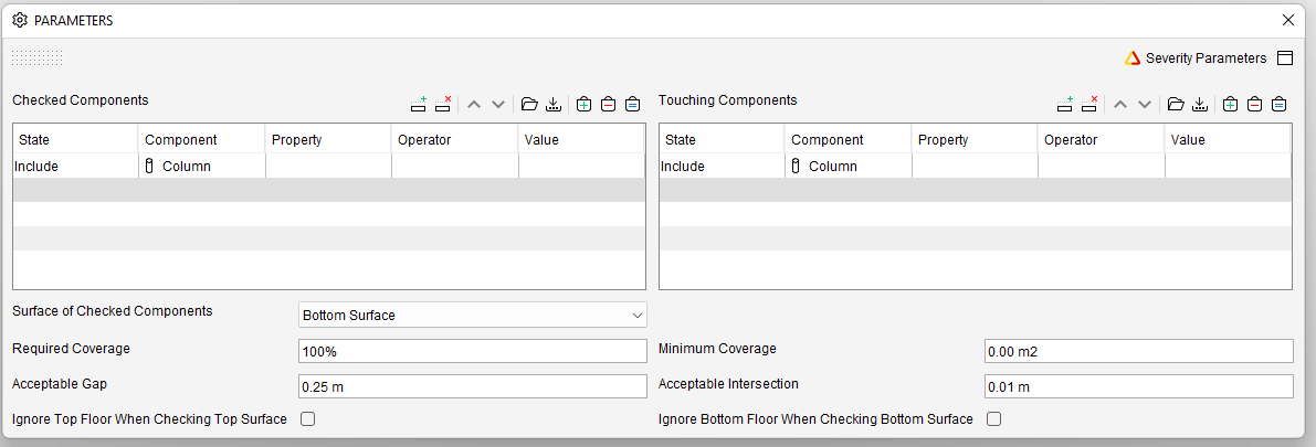

    Hi, I’d like to find if a column above is the same size or smaller and same type.

      Rule #23 would be good in your use case:
      This parametrization checks that bottom of a column is fully covered with another column.
      You could also add slabs there as Touching component or exclude bottom most floors.
