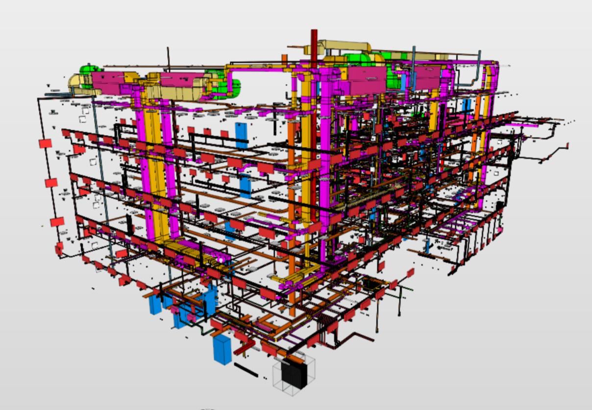

    Example:
    This is an updated Model (showing the elements via the model tree)

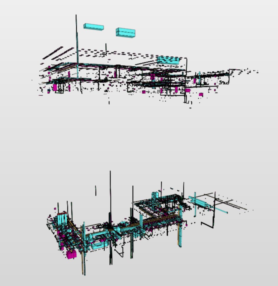

    … and this is the result of a classification in a scenario described above and clearly not reflecting the updates of the model. Not present GUIDs are not present any more, but new elements are not considered.
