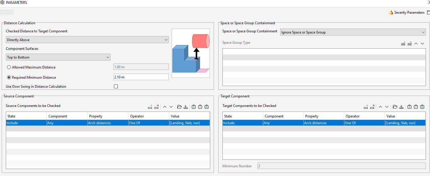

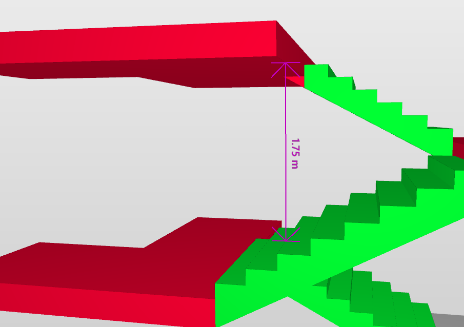

    I have a classification for landins and runs. And I have this situation:
    I’d like to find it with this rule, however it does not give me this problem:
    How can I fix it or perhaps I should use another rule?

        the issue is that accessibility rule gives quite many results. I’d like to know only if there is enough head space. So I thought that minimal distance rule should work, but is seams stairs do not work with it like slabs do.
        In any case minimal distance rule should work or does the element need to be more regular shape?
