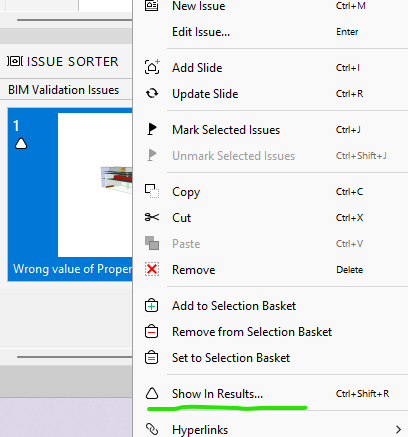

Go directly from Issue in Communication to Result?
When sifting through the presentation I often want to go to the checking result. Is there a way to do this?
/Mats -
@Mats_Knutsson
Right click on isseu in presentation.
Click in the pop-up menu go to issue in ruleset -
That was my idea but I don’t have that option…!?
@Mats_Knutsson if the presentation is created from checking the results, then that option is available.
Ok now it is there. Thx. I must have fiddled around so much the original rule I wanted to go to was deleted/changed and thus greying out the option.
