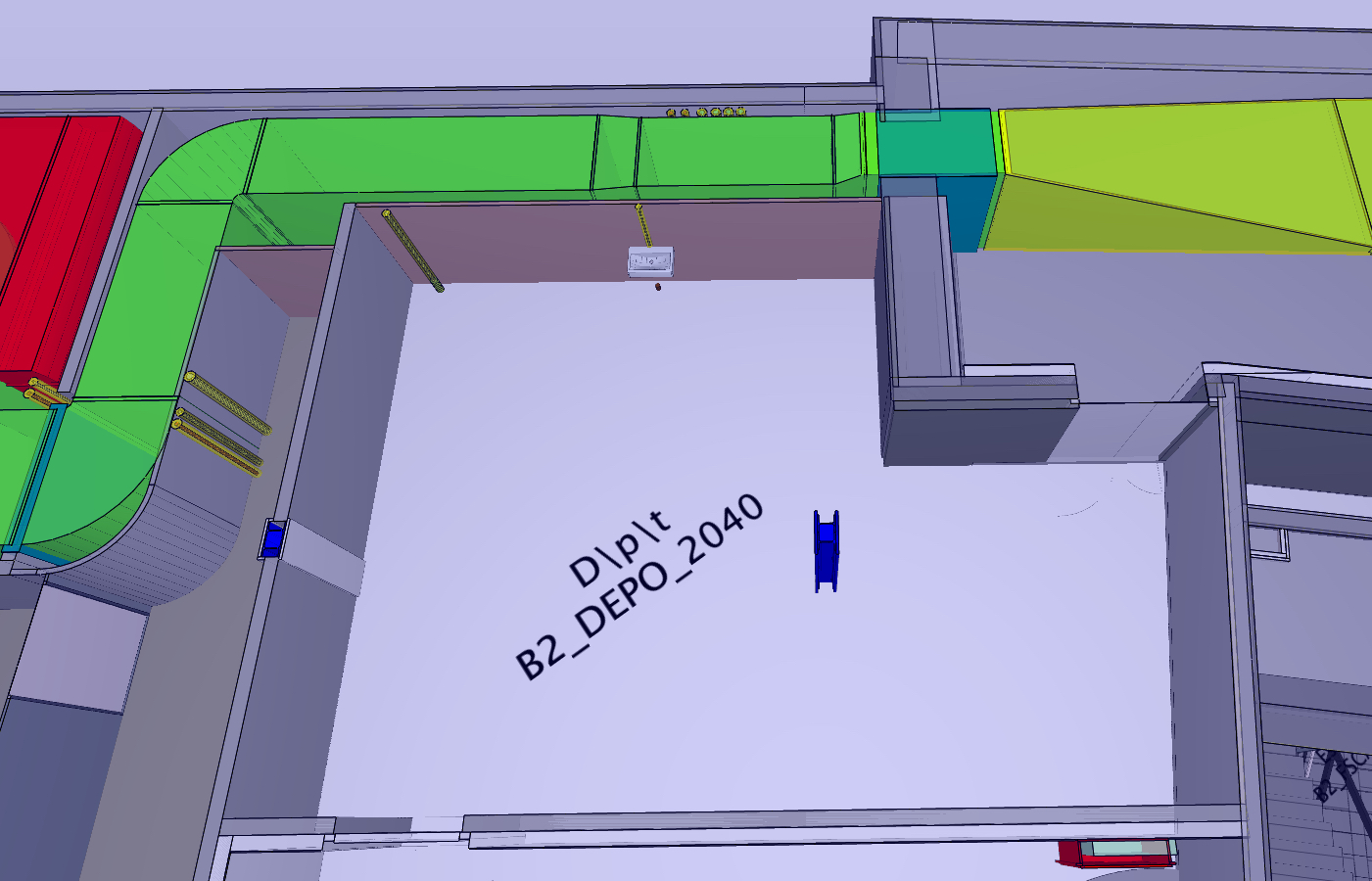

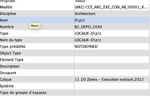

    Would it be possible to render the correct encoding for special characters on Mac?
    I have no problems on my side because I’m on Windows but my colleagues see this :

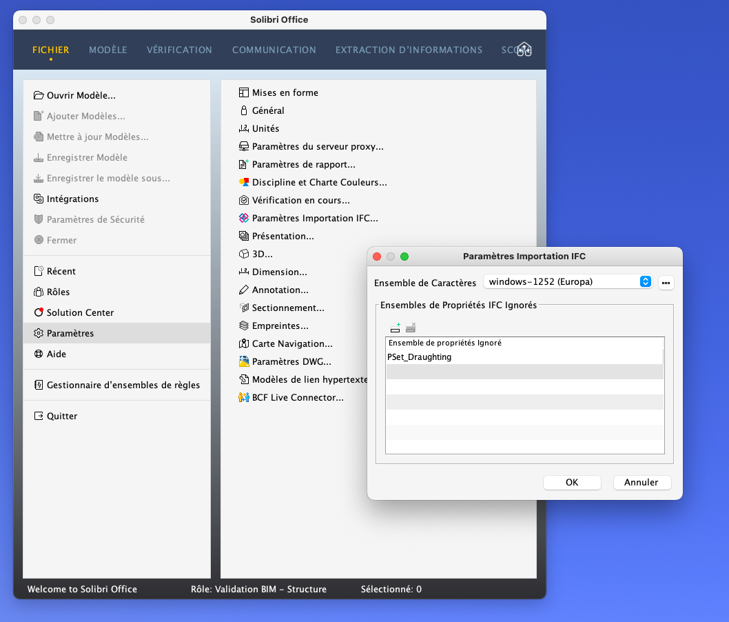

      @mathieu-farine this is related to the encoding character choices when importing IFC.
      It could be set here:
