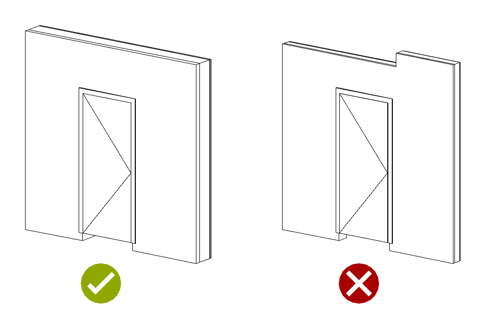

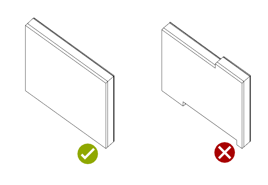

    I am interested in a solibri rule that would help me to check the correct geometry of the wall. Correct geometry is a rectangular wall with no cutouts or notches. Incorrect wall geometry created after intersection with other objects (other walls, flooring), resulting in the formation of grooves and indentations.

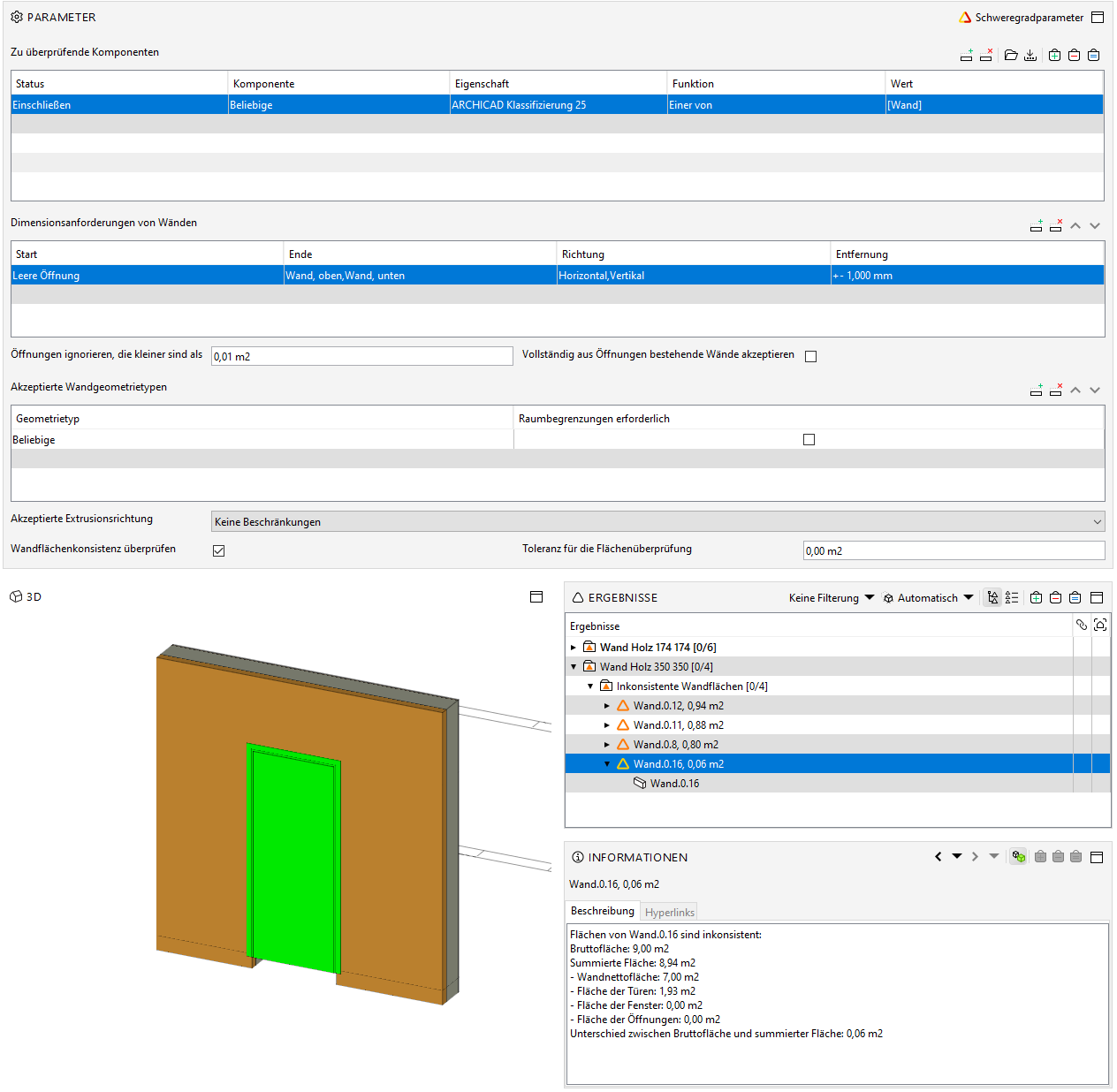

    At the moment I am trying the rule “216 Wall Validation” (support tag: SOL/216/2.0) with the parameter “Check wall area consistency”. However, this rule does not work so well when I need to check the geometry of the wall where the door is located. Since there is also a floor under the door, the door is raised from the bottom of the wall, so the rule points out the error where there is none. As far as I know, the parameter “Check wall area consistency” compares the gross wall area with the net area of the wall and door leaf, and then the distance from the bottom edge of the wall to the door leaf represents an error for the rule.
    However, this test result does not suit me. I would like to get the following result: Please take a look at the diagram.
    Could you recommend me another way to check if the wall geometry is correct, another rule or another setting for rule 216?

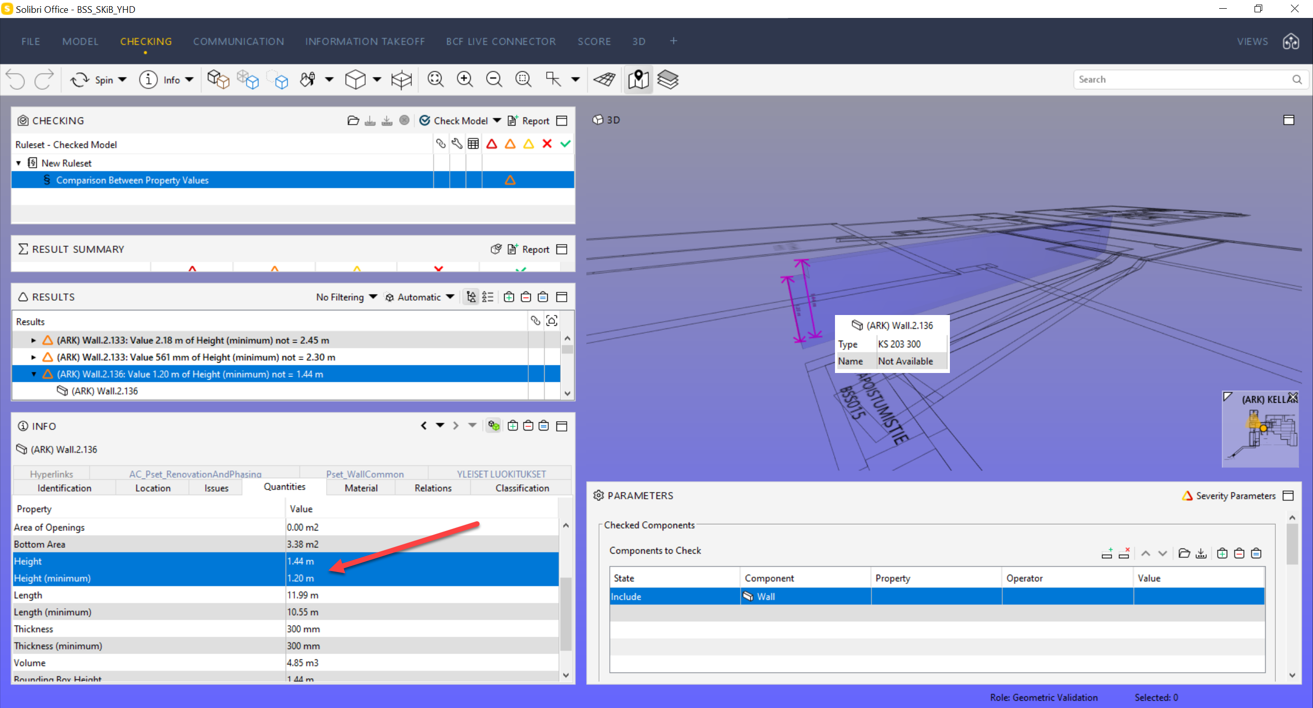

      One way to check this would be with rule #231 by comparing the wall values “Height” vs “Height (minimum)t”:
      You can try with this example rule if it works:
      example rule.cset
      S 1 Reply Last reply

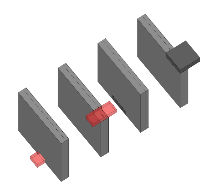

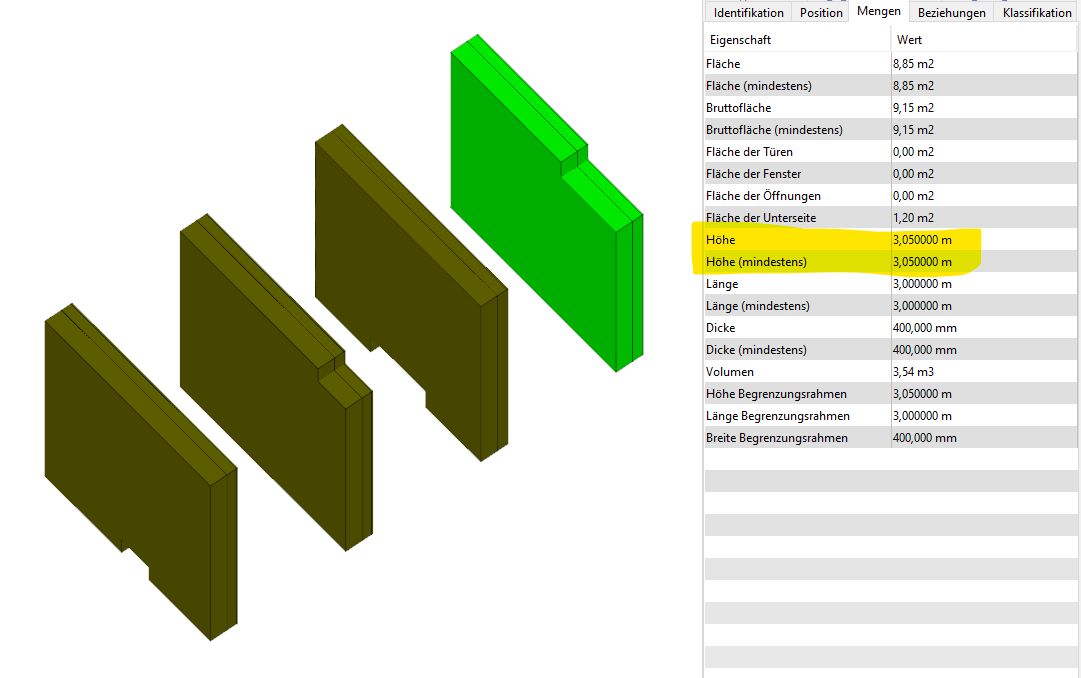

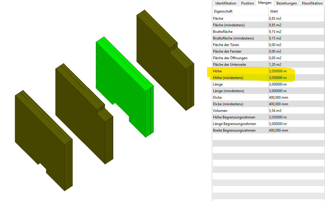

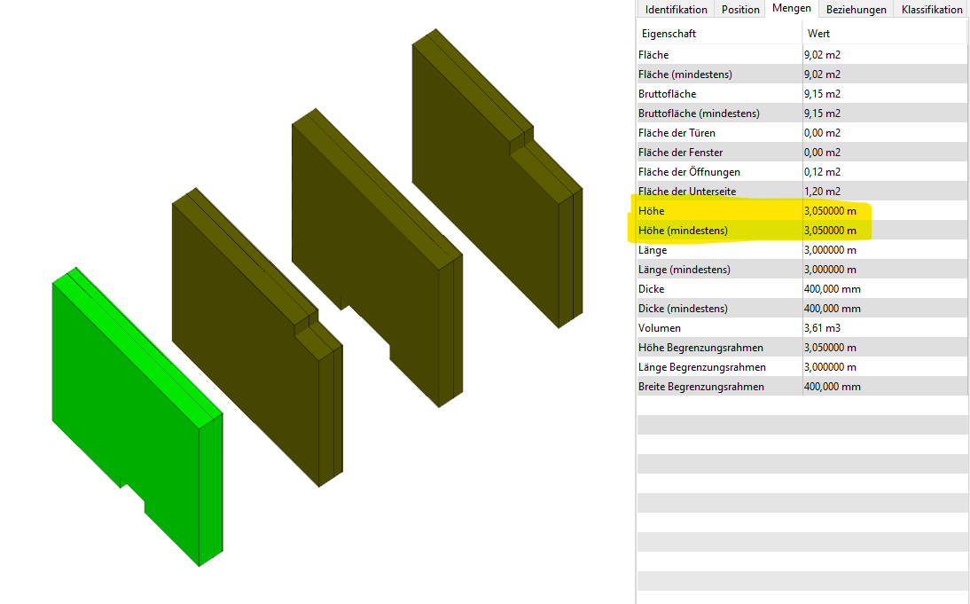

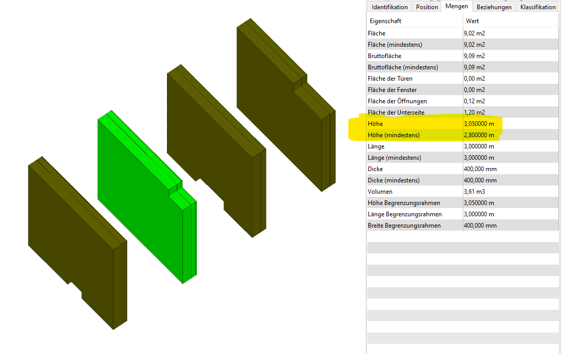

        Unfortunately, Quantities do not always represent the exact result for me. I have tested how the Height and Minimum Height of the wall will be presented depending on what is cut into the wall: the floor slab or the opening (red). Please have a look at the results:
        That is, in most cases, there is no difference between height and minimum height (although this is not the case). Do you encounter the same problem?
        Thanks in advance.

            @Lauri-Luoma I had to redo it, but the result is the same, I see no difference between the Height and Minimum Height in QuantitiesStanislava_Solibri_Quantities Test.ifc
