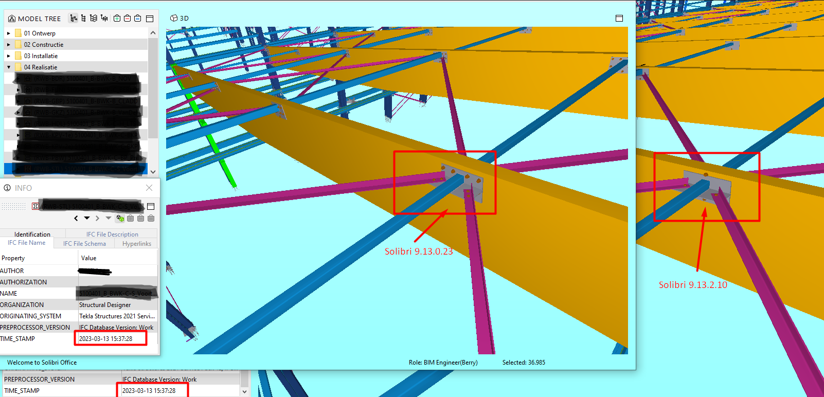

Is this (screenshot) a bug in Silibri version 9.13.2.10?
when i load the ifc files in this version not al bolts are visual.
When i load the same files in a previous version (9.13.0.23)
the bolts are visual.
@Sander-E @Matti-Kannala
Hi, you’re right, and it’s resolved now, thanks!
The ifc was updated on a pc where the version was still 9.13.2.10, and then I opened it with version 9.13.3.18.
Now I’ve updated the ifc with version 9.13.3.18, and now it looks correct

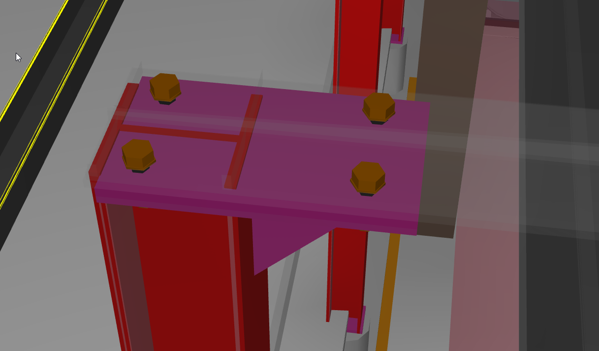

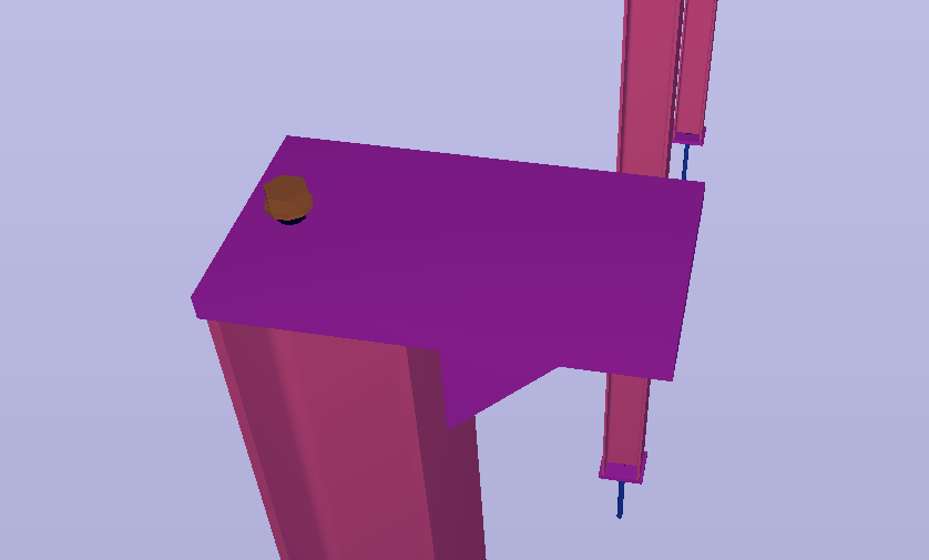

@Anil Hi Anil, I’ll send another case related to this issue to [email protected]
See also this topic!
@Sander-E @BvanDalsum @RobinKramer
This will be fixed in the next version 9.13.3. The beta should be out in couple of weeks.
