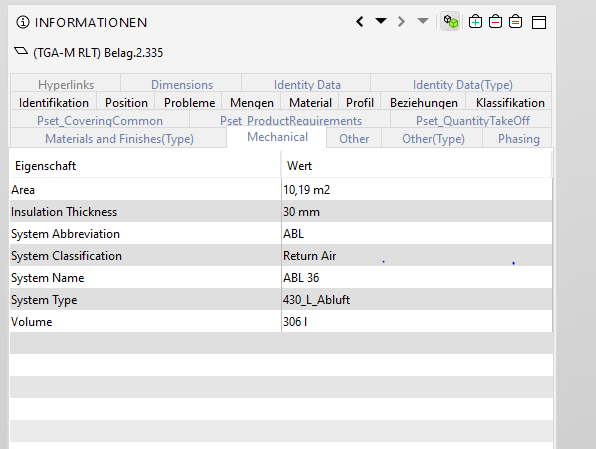

    When I export an IFC with a drainage system from Archicad, I cannot get the Mechanical Tab to show in solibri.
    the tab appears, however, when I open an HVAC Modell done in Revit (attached image).
    does anyone know where the tab comes from. I need it to know the System Classification.
    I apprecitae any help here. Thank you
      Sander E
      First of al: is it Solibri that didn’t see it? Or is the tab not present in the ifc.
      To to find that out try it to open in another ifc viewer, like BIMvision.
      If the problem is in the ifc, you should find out how to export an special tab for ifc when you make an export from Archicad.
      • G Offline
        G Offline
        Gon
        Thank you very much for your reply and my apologies for answering late.
        I opened it with another Viewer and the solution is that first I have to create the Mechanical Set with its attributes in Archicad.
