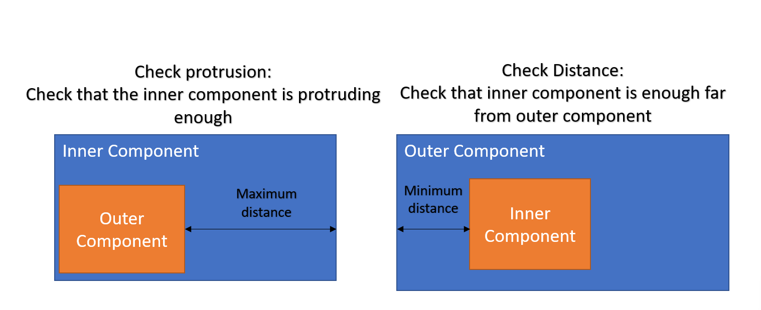

      replied to MarwaShaheen 0 on last edited by
      @MarwaShaheen-0
      The rule 234 Component Inside Component is sometimes a bit hard to configure and understand.
      Here is some tips that might help you in the use of that rule:
      • The rule always finding a single dimension that it is comparing to min and max values
