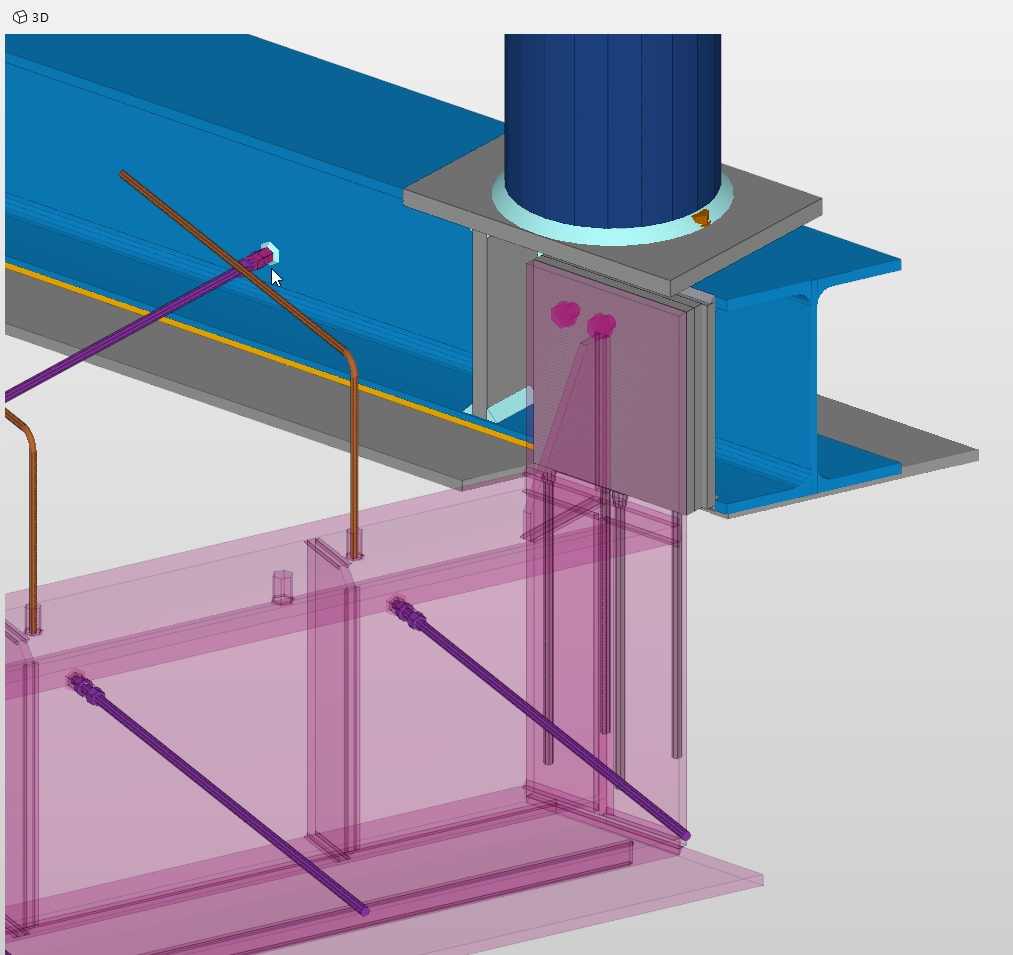

    We encountered a problem with an IFC2x3 from Tekla.
    The Fasteners who are placed in an Assembly are not in correct place.
    I even think they are on top of each other.

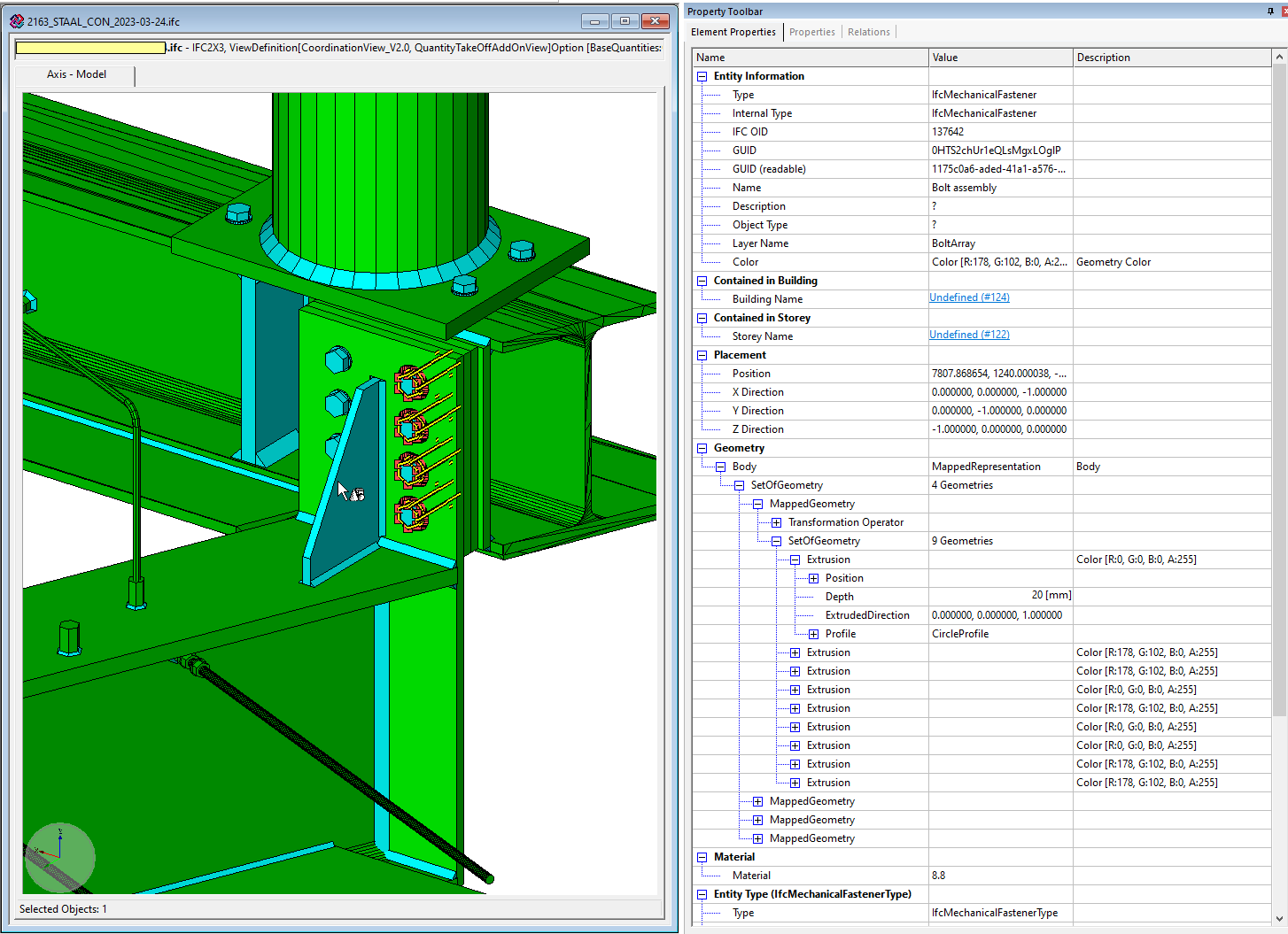

    In other viewers (FZK, BIMcollab ZOOM) and in Revit everything is fine. So the IFC itself should be ok.
    Does anybody recognize this problem? Is there a solution. Perhaps we will try IFC4 export
    Is this only a visual problem, or is this also effecting clash results or calculations?
    Thanks,

      I guess your issue is related with this post:
      https://society.solibri.com/topic/2303/serious-bug-solibri
      What solibri version are you running? I would suggest to try an older version.

        @Ricardo Thanks!
        This must be the case.
        MattiM 1 Reply Last reply
          replied to teun_1 on last edited by
          @teun_1 @Ricardo
          We are sorry for this. This will be fixed in the next release.
