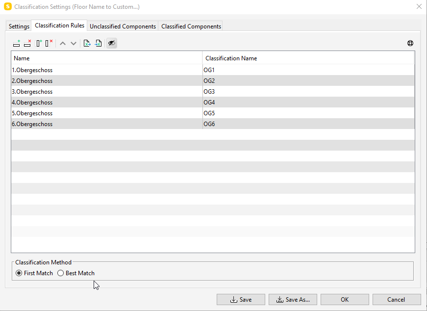

      Hi @agroni
      Create a classification that maps the floor name to the value of that PSET:

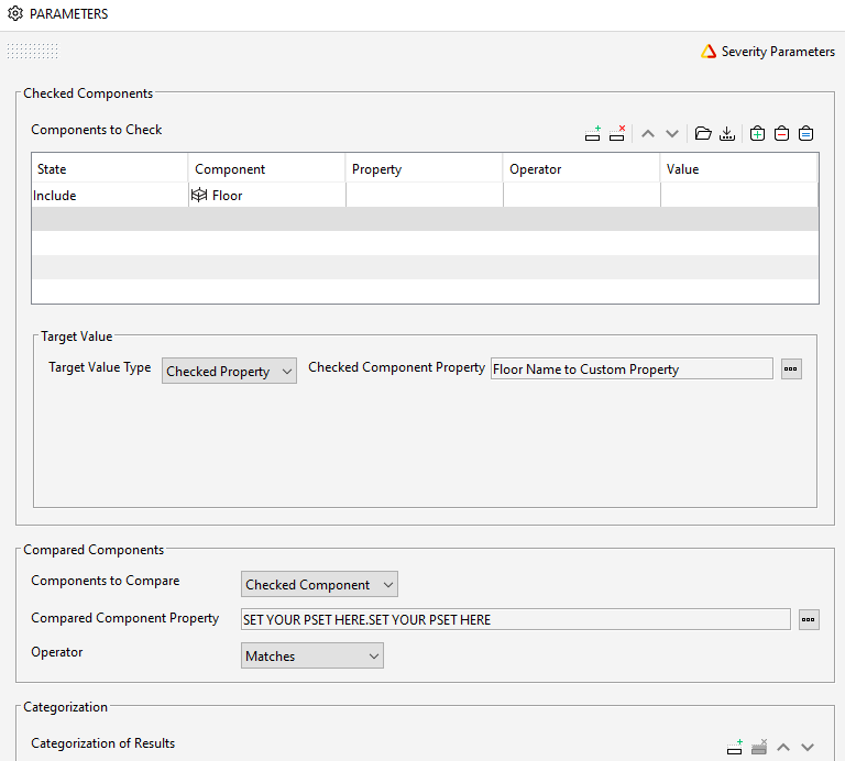

      Then use 231 to check the value of that classification matches the PSET value for the floors something similar to this: 9e94defa-9715-41d1-83b6-e0bc271e2302-image.png

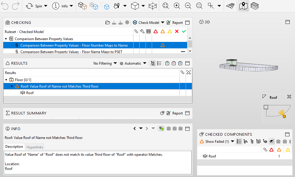

      I tested it and it worked mapping the Floor number to the Floor name where I purposely made if fail on having “Roof” not be named “Third floor” with the sample model.
      Here is the SMC: Solibri Building - Comparison Between Properties.smc
