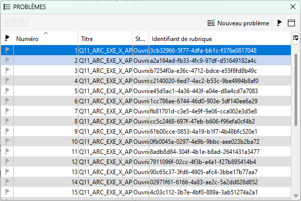

    On a project we share BCF (2.1 and 3) files to engineers and they open it directly in Revit via the BIMcollab BCF Manager.
    One of these engineers reported me that the Index (or the Number) of the BCF are wrong between what lies in our PDF reports and what they see on BIMcollab.

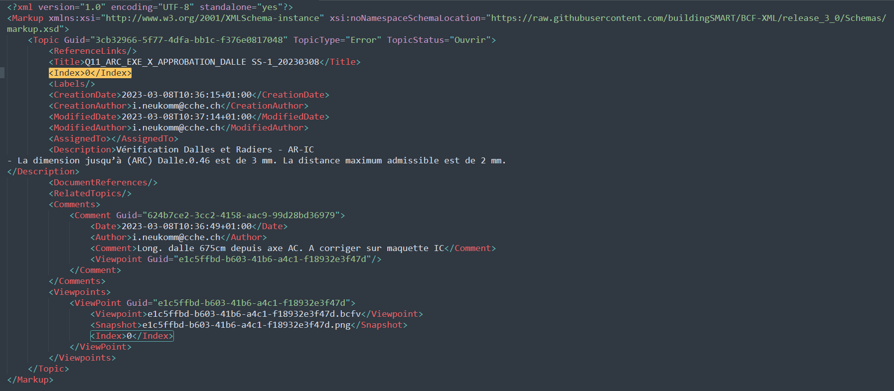

    So I had a look on the files and that is what happens in Solibri
    3cb32966-5f77-4dfa-bb1c-f376e0817048 = Index 1
    3cb32966-5f77-4dfa-bb1c-f376e0817048 = Index 0
    Do you think we could unify that?
    Even if the BCF index is bound to disappear?
