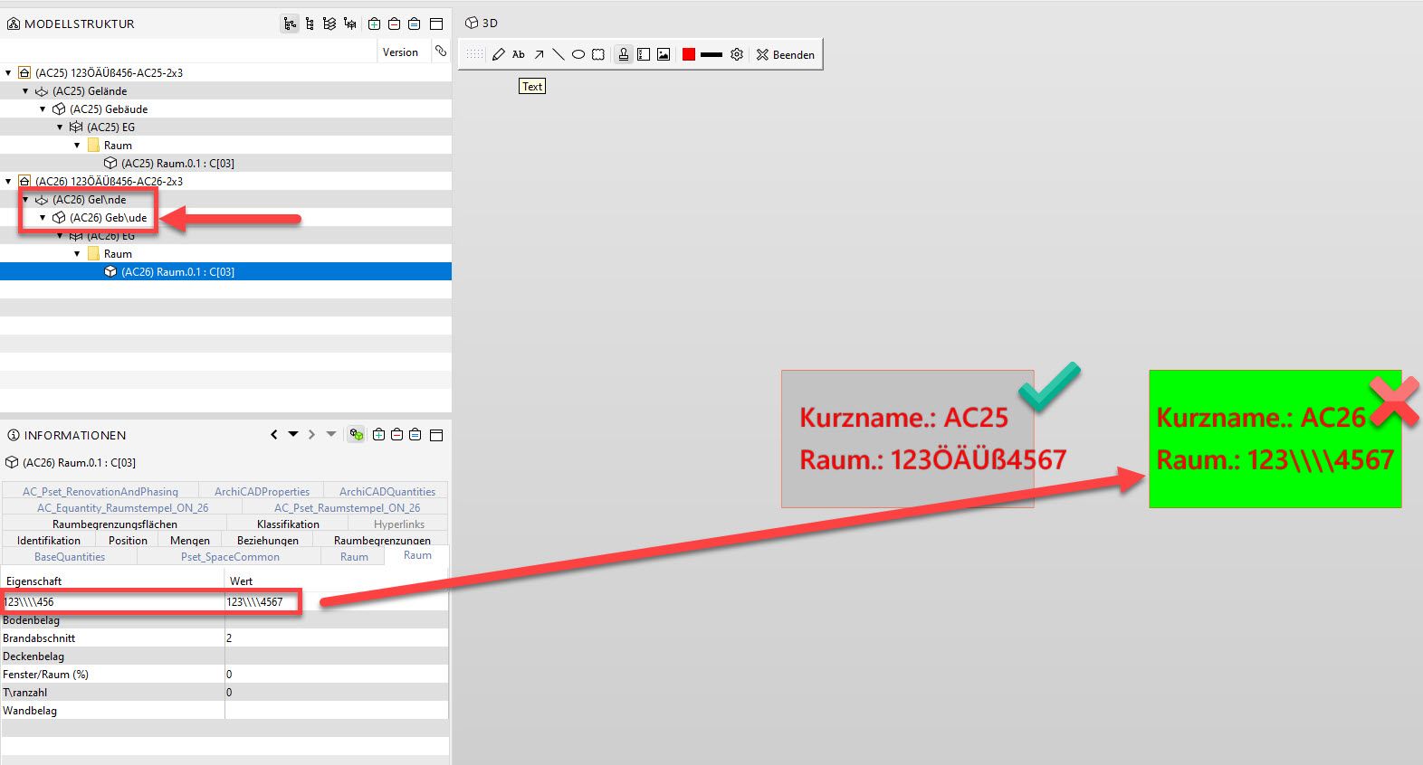

    In the attached File there is a single IfcSpace with Property Set “Raum”, where you can find Property “123ÖÄÜß4567” with the same Value “123ÖÄÜß4567”. So the first entry in the Ifc is the Property, followed by their Value:

            I was able to open both files with UTF-8 setting in latest Solibri (9.13.4.19). I also checked the files. They both have encoded the umlaut characters, although in different ways.
            AC 25 does it like this:
            #1132= IFCPROPERTYSINGLEVALUE(‘123\X2\00D600C400DC00DF\X0\456’,$,IFCLABEL(‘123\X2\00D600C400DC00DF\X0\4567’),$);
            and AC26 like this:
            #259=IFCPROPERTYSINGLEVALUE(‘123\X\D6\X\C4\X\DC\X\DF456’,$,IFCLABEL(‘123\X\D6\X\C4\X\DC\X\DF4567’),$);
            They both seem valid. We may have had some problems with the way AC25 did the encoding and that is fixed in the latest version.

                  @Pasi-Paasiala To make this clear, this is still happening with 9.13.4.19.

                      Also another incompatible file I got today, exported from Revit 2021, is encoded the same way as the following line illustrates:
                      #34059= IFCPROPERTYSINGLEVALUE(‘Reference’,$,IFCTEXT(‘UV_O5_Freifl\X2\00E4\X0\che’),$);
