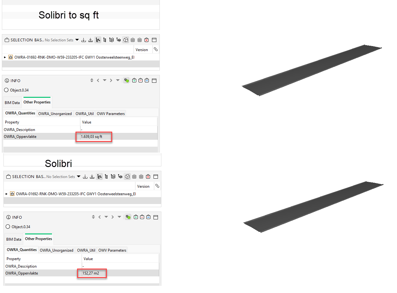

    For an infrastructure project we noticed a difference in a wanted quantity between de model and de IFC viewer in Solibri. The correct quantity is 1639,03m² but in Solibri it gives 152,27m². When I change the units from m² to sq ft I get 1639,03 sq ft. And that is the correct value but with the wrong unit… what is going wrong? Is this a bug?

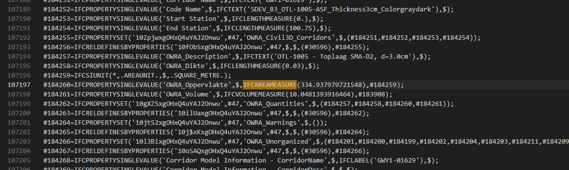

        Is this happening with all property sets in this model?
        Could you check your IFC file with text editor:

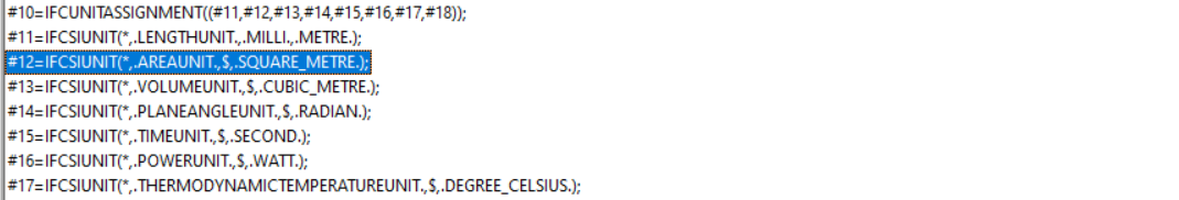

        The IFC file should have the units defined like this:

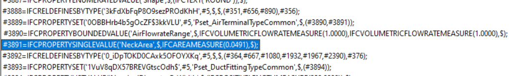

        The area properties should be defined using IFCAREAMEASURE:
        S 1 Reply Last reply

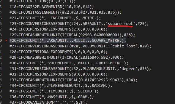

          SanneVertommen
          @Matti-Kannala
          Hi, Thank you for your reaction. I find square meters but above there is a conversion to square foot.
          This is oke to me
            Pasi Paasiala Solibrians
            I think this same case was sent to our support as well. In that file, the area unit is registered as sguare_foot in the IFCUNITASSIGNMENT. Solibri uses those units. I remember that one particular property referring to square meters as unit, but Solibri does not take that into account, since it is not listed in IFCUNITASSIGNMENT. I have an inkling that only the units listed in IFCUNITASSIGNMENT should be used in an IFC file, but cannot confirm that right now.
