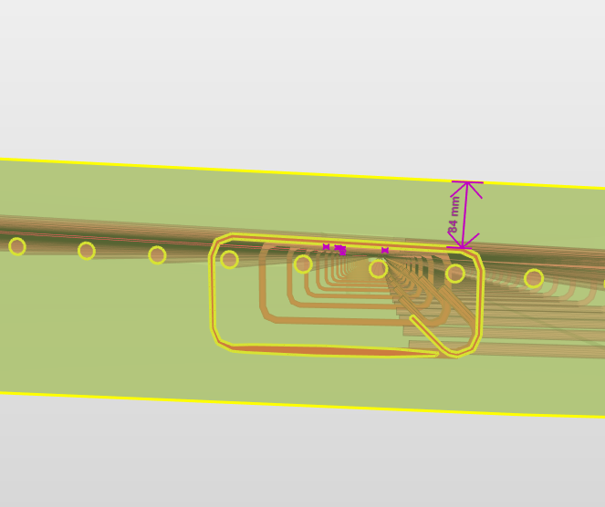

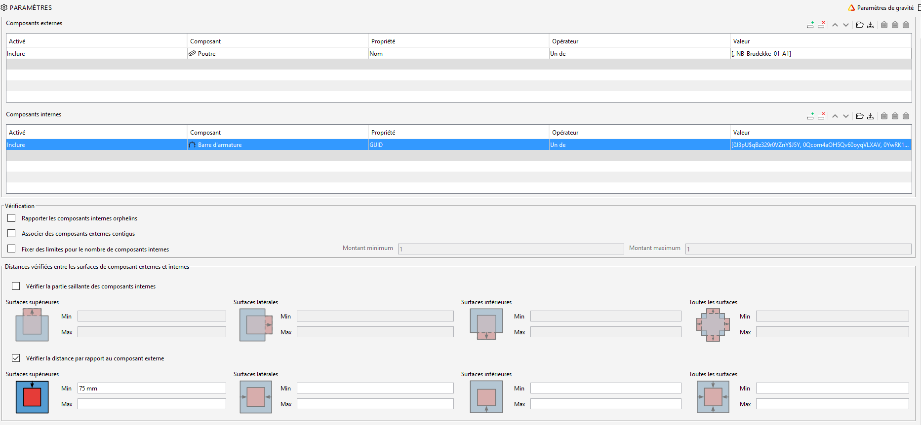

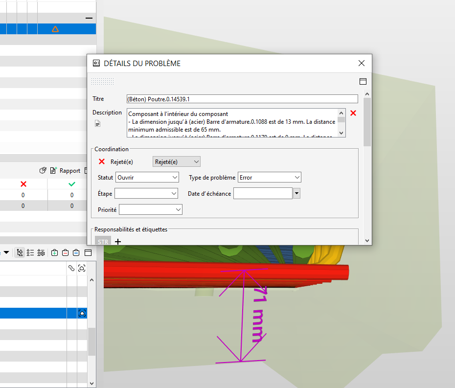

    im checking the distance between steel and concrete and i specified a distance 65mm in all surfaces and i dont understand why solibri keeps showing me that the distance is incorrect while i measured it manuly and i found 71mm for example
    can anyone explain that to me

      I don’t see the inner and outher setting good enough. And even the rule result text is not vissible.
      But is the side 65mm?
      You can try to split it up and check only the underside.

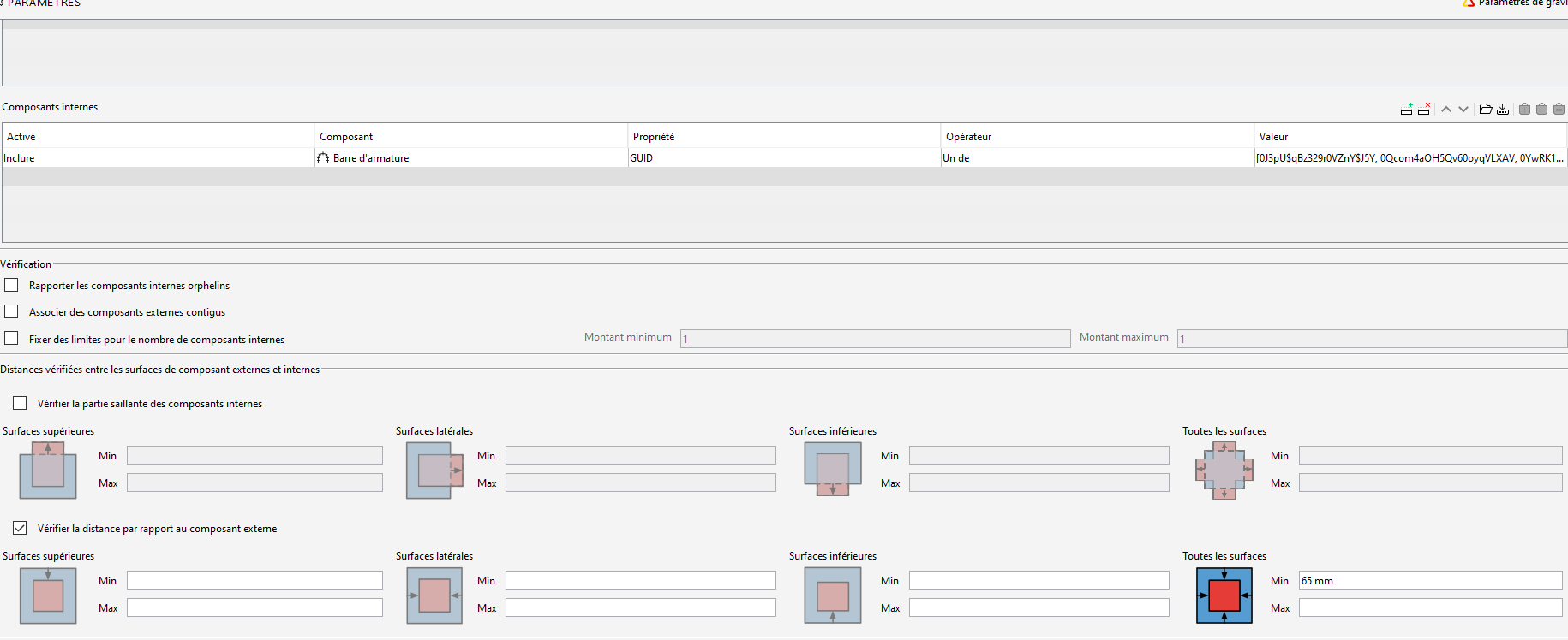

        i did put only one parametre this time and i checked but i think that i still have the same problem
