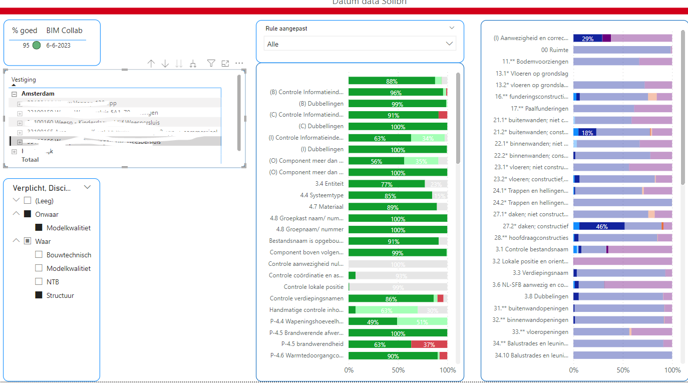

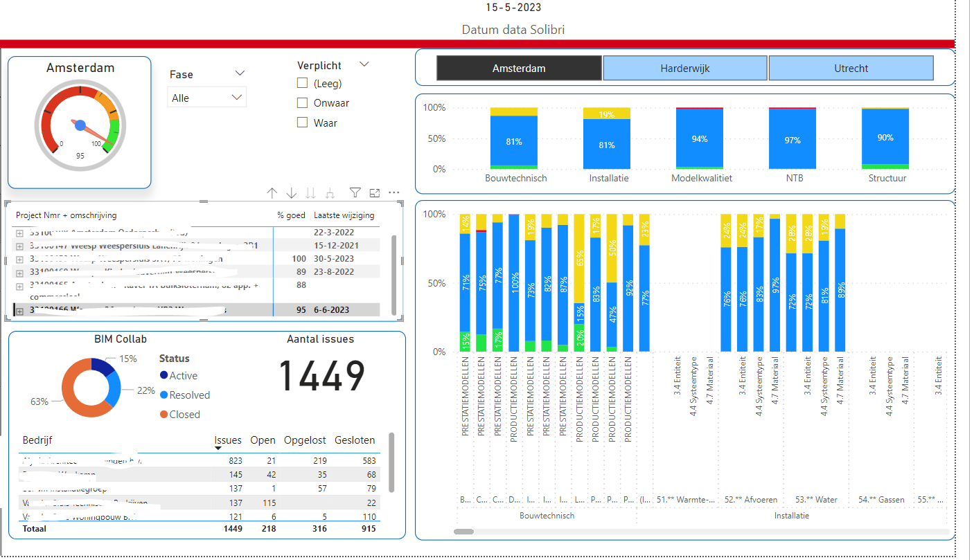

      The snapshot is the example of the Power Bi Dashboard.
      The 5 pilars of a good model.
      Also possible to deepdive in the data
