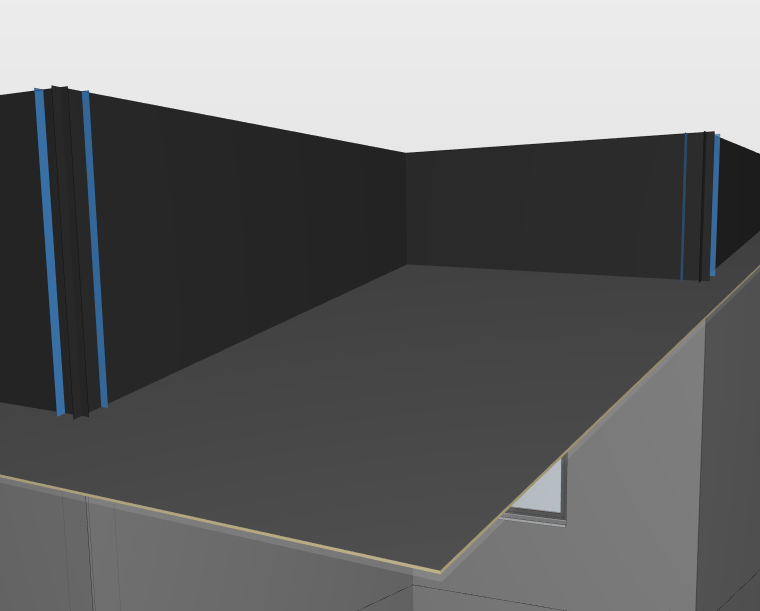

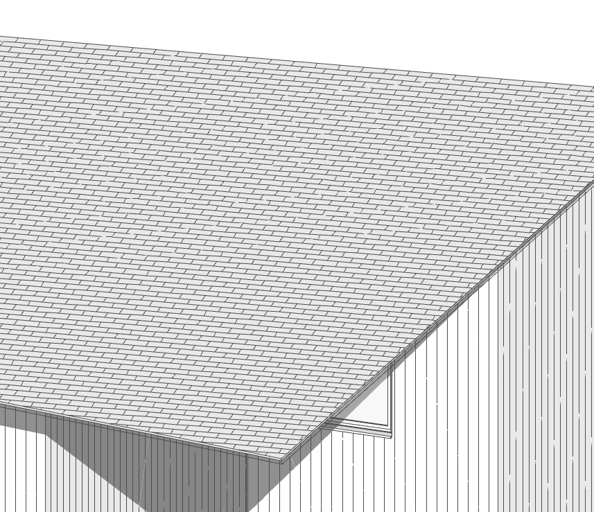

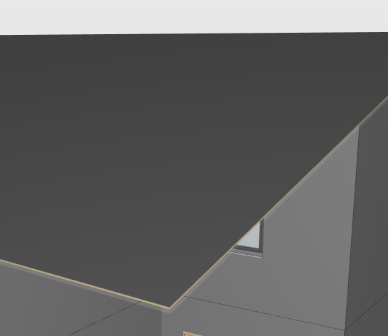

    I have issues with thin materials like 0,2mm damp-proof membranes in composit-walls misbehaving when published from ArchiCAD to ifc and opened in Solibri.
    ArchiCAD view
    Solibri view with 0,2mm wind barrier and damp-proofing
    Solibri view with 1mm wind barrier and damp-proofing
    So is 1mm a limit for material behavior in Solibri or is there a way for this to work? For ArchiCAD documentation its beneficial to have the possibility of portraying exact thicknesses, but for IFC presentation this does not look good.
      Pasi Paasiala Solibrians
      @ats Could you provide a simple IFC file to replicate this?
