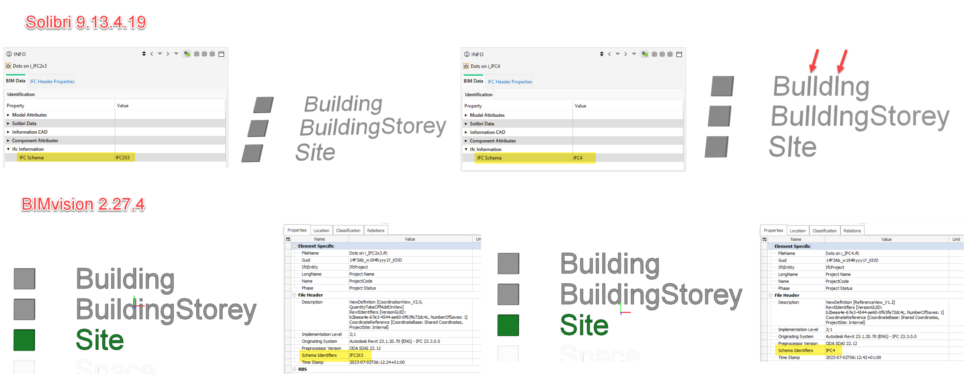

    It literally concerns the dots on the i’s.
    The representation in Solibri in IFC2x3 seems to be OK, but there is an issue in IFC4.
    In the screenshot below a comparison is made with the representation in BIMvision, where the representation (with the dots on the i’s) is equal for IFC2x3 and IFC4.
    Dots on i_IFC4.ifc
    Dots on i_IFC2x3.ifc
      Pasi Paasiala Solibrians
      @dvrvb Thanks for reporting. We’ve added an issue about this.
