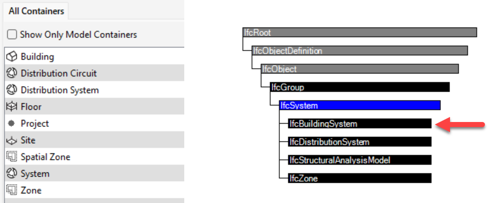

    Next to (the generic) Solibri container System, the containers Distribution System and Distribution System has been added (for IFC4).
    Should the container Building System not also be added?

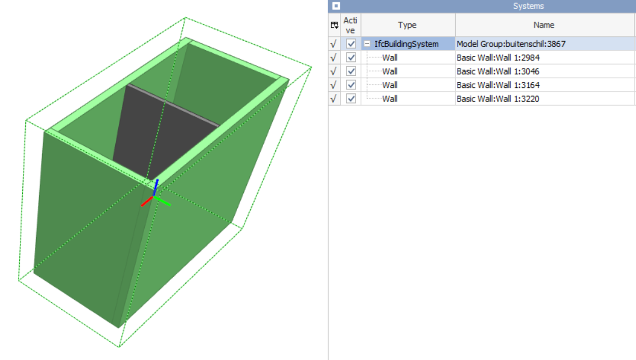

      @dvrvb Do you have any sample IFC files to share?
      dvrvbD 1 Reply Last reply
      • dvrvbD Offline
        dvrvbD Offline
        dvrvb
        @Pasi-Paasiala
        Attached a simple straightforward sample where the 4 outerwalls are contained in IfcBuildingSystem.OUTERSHELL
        IfcBuildingSystem_IFC4RV.ifc
        P 1 Reply Last reply
          Pasi Paasiala Solibrians
          replied to dvrvb on last edited by
          @dvrvb Thanks!
