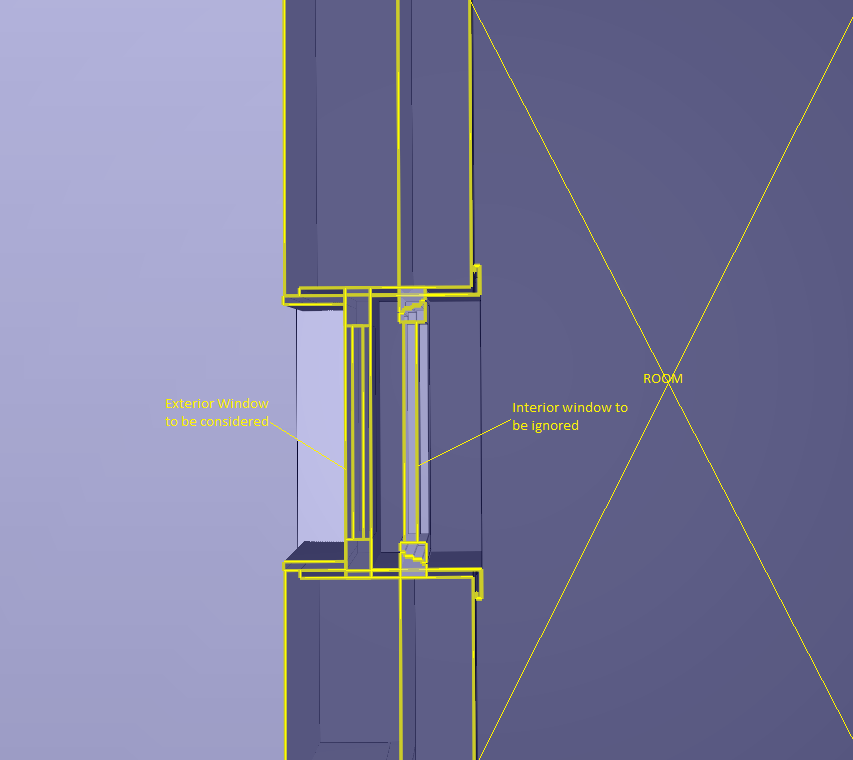

    Good morning everyone,
    I have a question regarding Rule 19/3.3
    I need to set a Rule that checks that the window area equals or is bigger than the 12% area of the room.
    The thing is, I have two walls and the one from the inside should not be considered; the one from the outside wall does.
    See picture below:
    Solibri is not taking into consideration the outside window at all.
    Can anyone please help me in this matter?
    Thank you so much!
      Pasi Paasiala Solibrians
      @JoVarSil92 You won’t get more light in the room, if you put two windows in the same opening.
