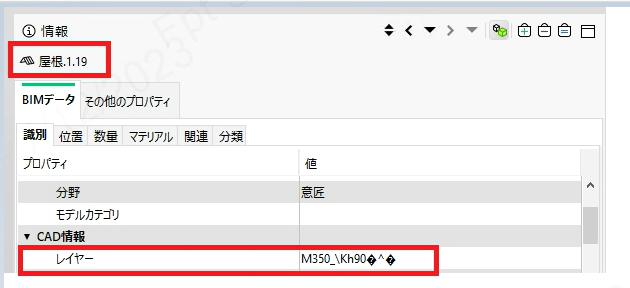

    I just downloaded 9.13.4 today and got an issue when property values of some components do not display correctly.
    When i import IFC using v9.13.4

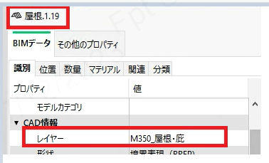

    Import using v9.13.3
    Because of this, my several developing rules are using these property values can’t run correctly.
    I think it is a font bug. Please fix it in the next update.

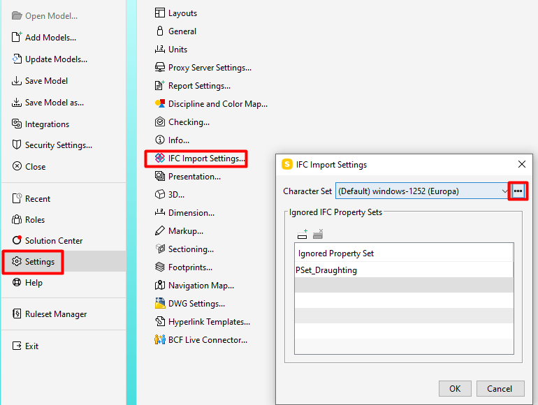

      Maybe this will do the trick.
      maybe you use the wrong Character set?
        replied to HieuVH-FPT on last edited by
        @HieuVH See also here: https://society.solibri.com/topic/2329/special-characters-and-umlauts-äöüß-2/12?_=1689319045101
        Try UTF-8 (or and reload your models)
