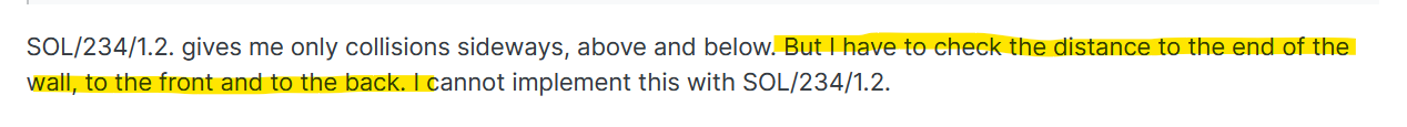

        @chs said in Distance from ProvisionForVoid to the end of a wall:
        SOL/234/1.2.
        SOL/234/1.2. gives me only collisions sideways, above and below. But I have to check the distance to the end of the wall, to the front and to the back. I cannot implement this with SOL/234/1.2.
        Can you possibly post an example of your solution?

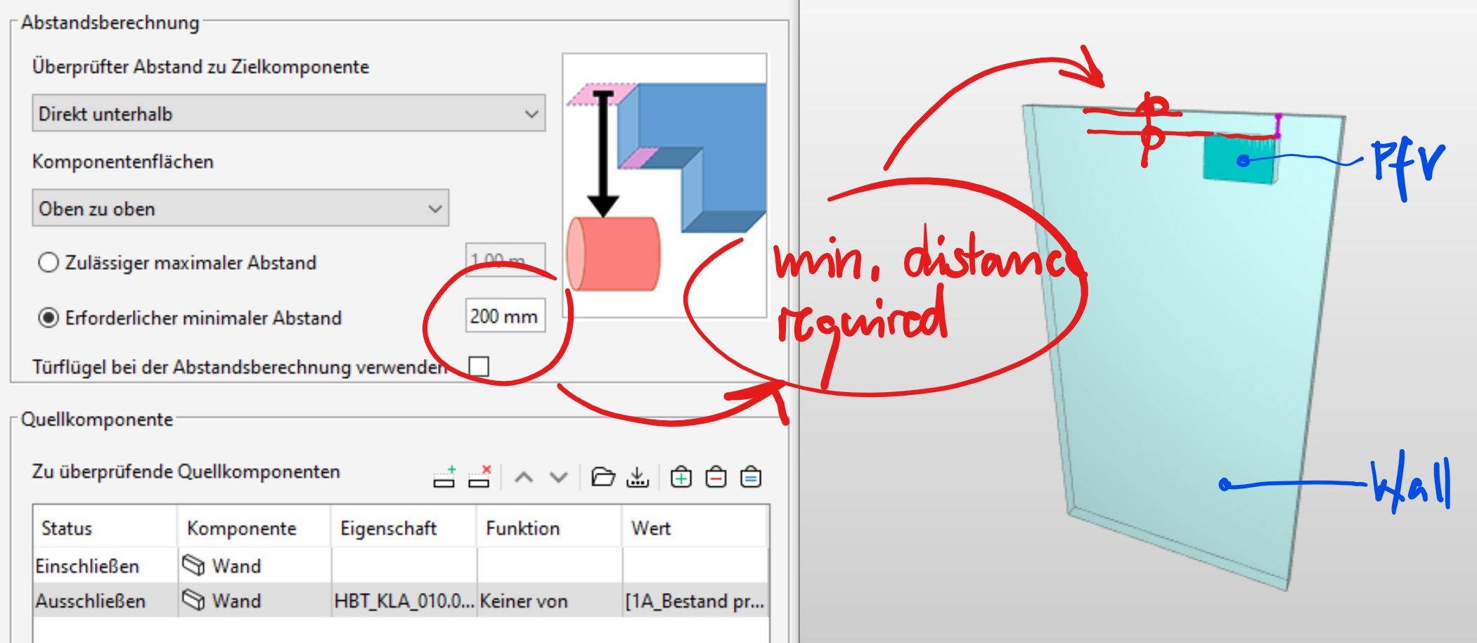

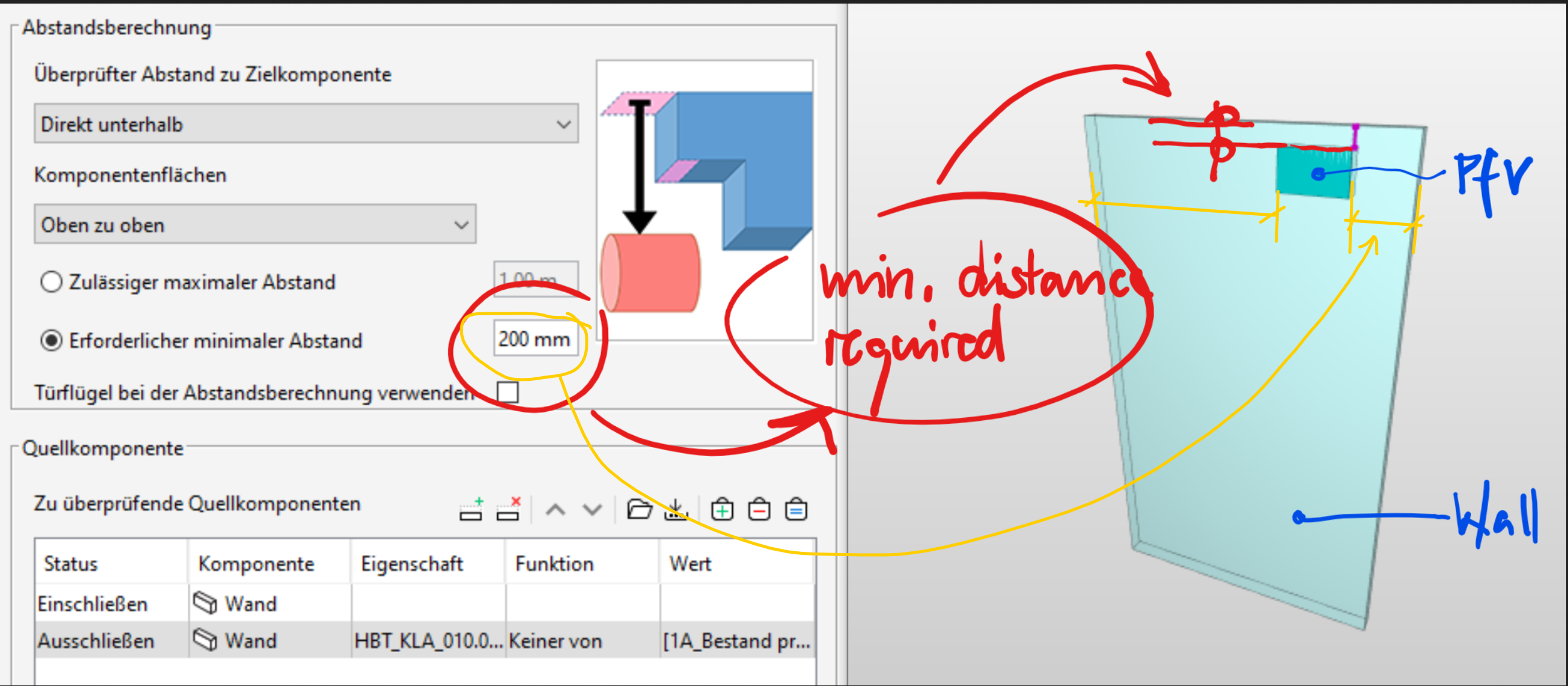

          Hi Kai
          Sorry it’s SOL/222/4.2 Here a screenshot to check PfV distance from upper edge.
          With SOL/234/1.2 you can check if PfV is completly inside the wall or not.

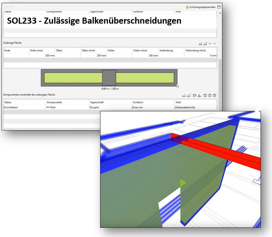

                  Hi Kai
                  SOL 233 should work. Developped to check beam intersections

                    replied to chs on last edited by
                    @chs This looks interesting! I will test it after my vacation.
                    Thanks for the tip.
