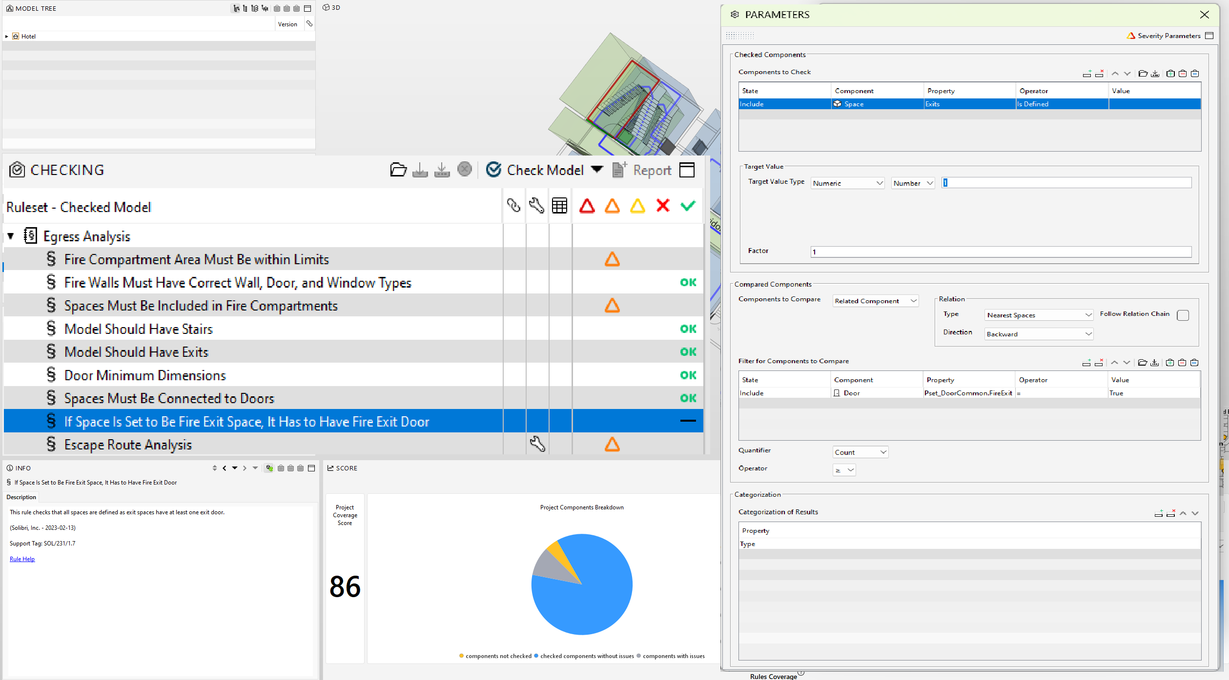

    i designed stairs as fire exit space but the program still doesnt respond
    what is the problem please
    any one help me please
      Pasi Paasiala Solibrians
      @Mohammadi Based on your screenshot, there are no spaces matching your filter. You should see this also in your Results view. You need to fix your filter first.

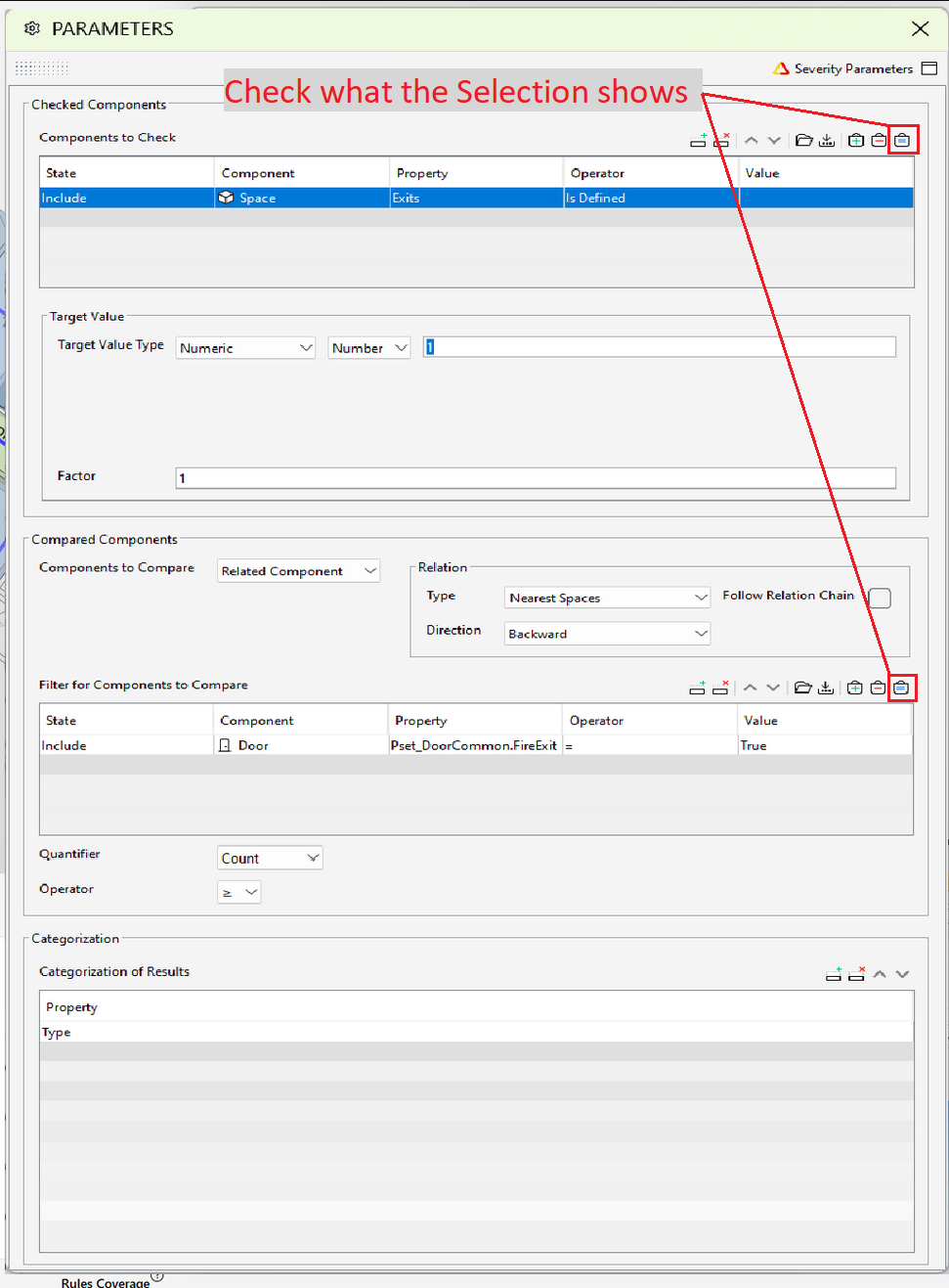

        Have you actually checked that there is a door who’s related to the space that you are checking?
        Can you also confirm that the doors in the project have the Pset_DoorCommon within the export and has given different values before running the check?

          @Mohammadi
          Also try checking in 3D view if those filters have actual components, by setting the selection basket from these filters:

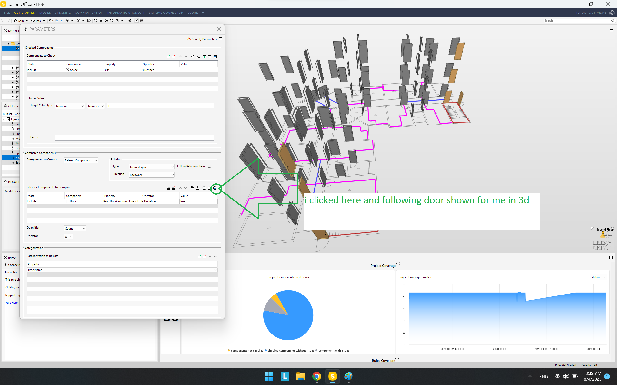

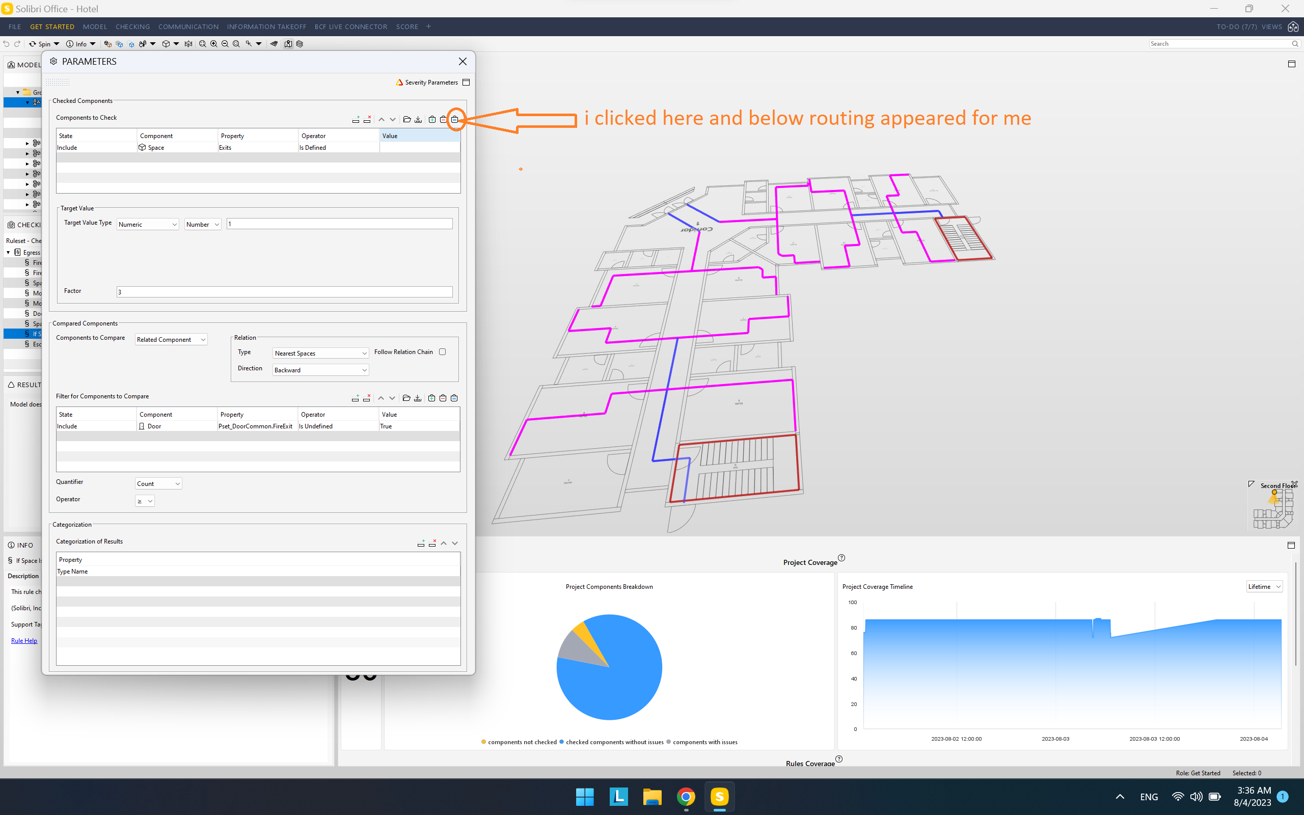

            About PSET-DOORCOMMON i dont have information but i choosed fire rated door for fire exit space which is fire staircase during modeling in revit.
