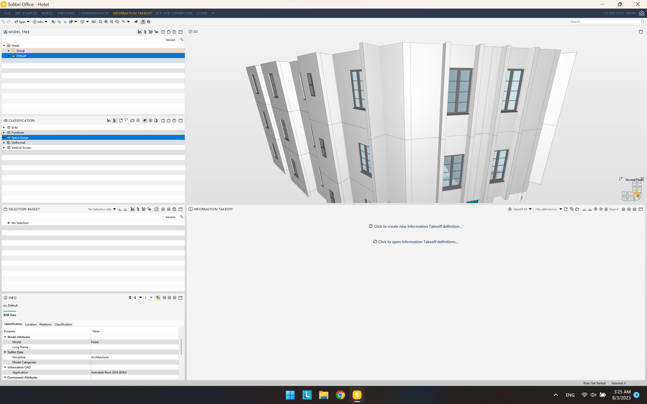

    Hi everyone
    where i can find space grouping?
    in below screenshot

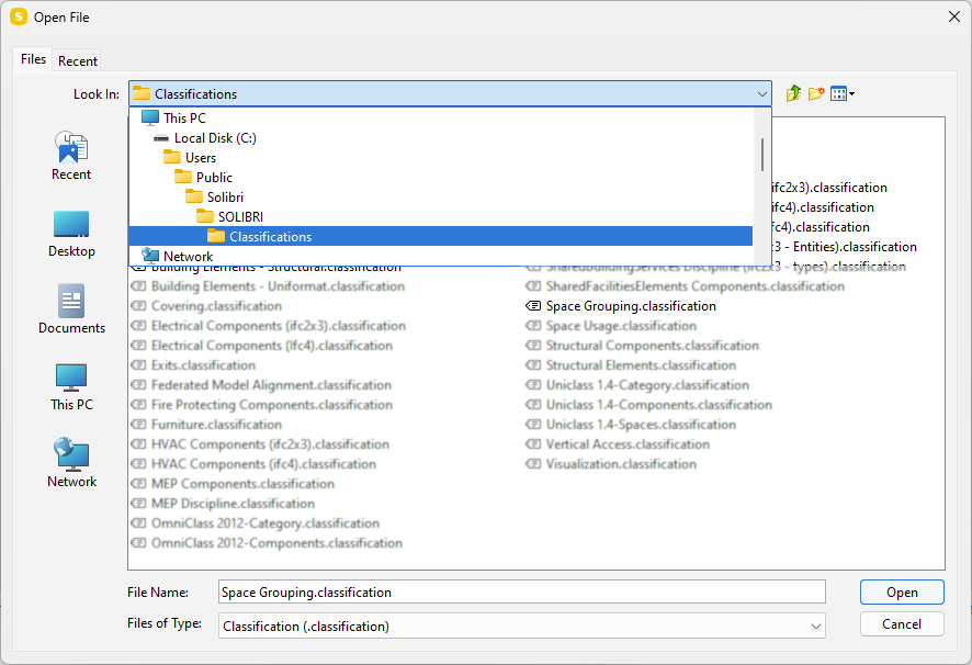

      If you are asking about the Space Grouping Classification that comes installed with a Solibri, as a resource it is located by default here:
      C:\Users\Public\Solibri\SOLIBRI\Classifications\Space Grouping.classification
      You can open it within Solibri via Open button in Classification View:
      • B Offline

        Within the Group folder (in the model tree) you will find the breakdown of the different groups that you have made. I consider that the best way to group spaces is with IfcZone
