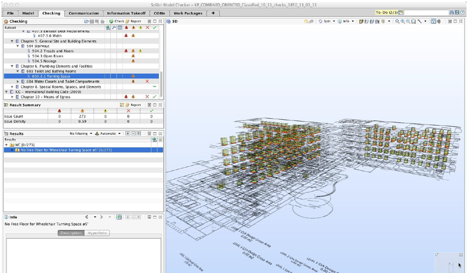

    does current version of Solibri deal with IBC as previous version as below example?

        @Mohammadi You may have been using the ADA and ABA accessibility extension that is available in Solibri Solution Center.
        In Solibri Go to File/Solution Center. If the extension is assigned to you, you should see it there. If not, you need to get it assigned to you in Solibri Solution Center by somebody that has admin rights in Solibri Solution Center.
