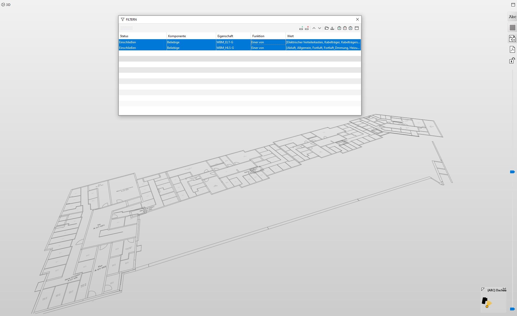

    Dear fellow Solibri users,
    I have stumbled upon a problem that I cannot solve myself.

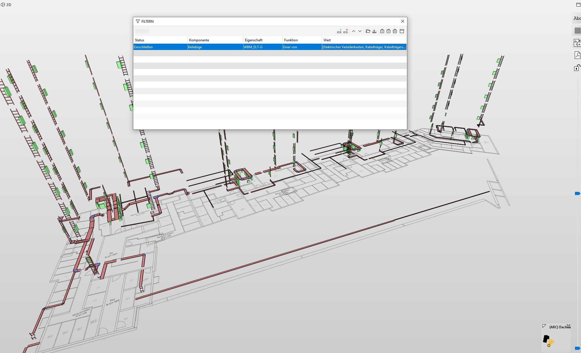

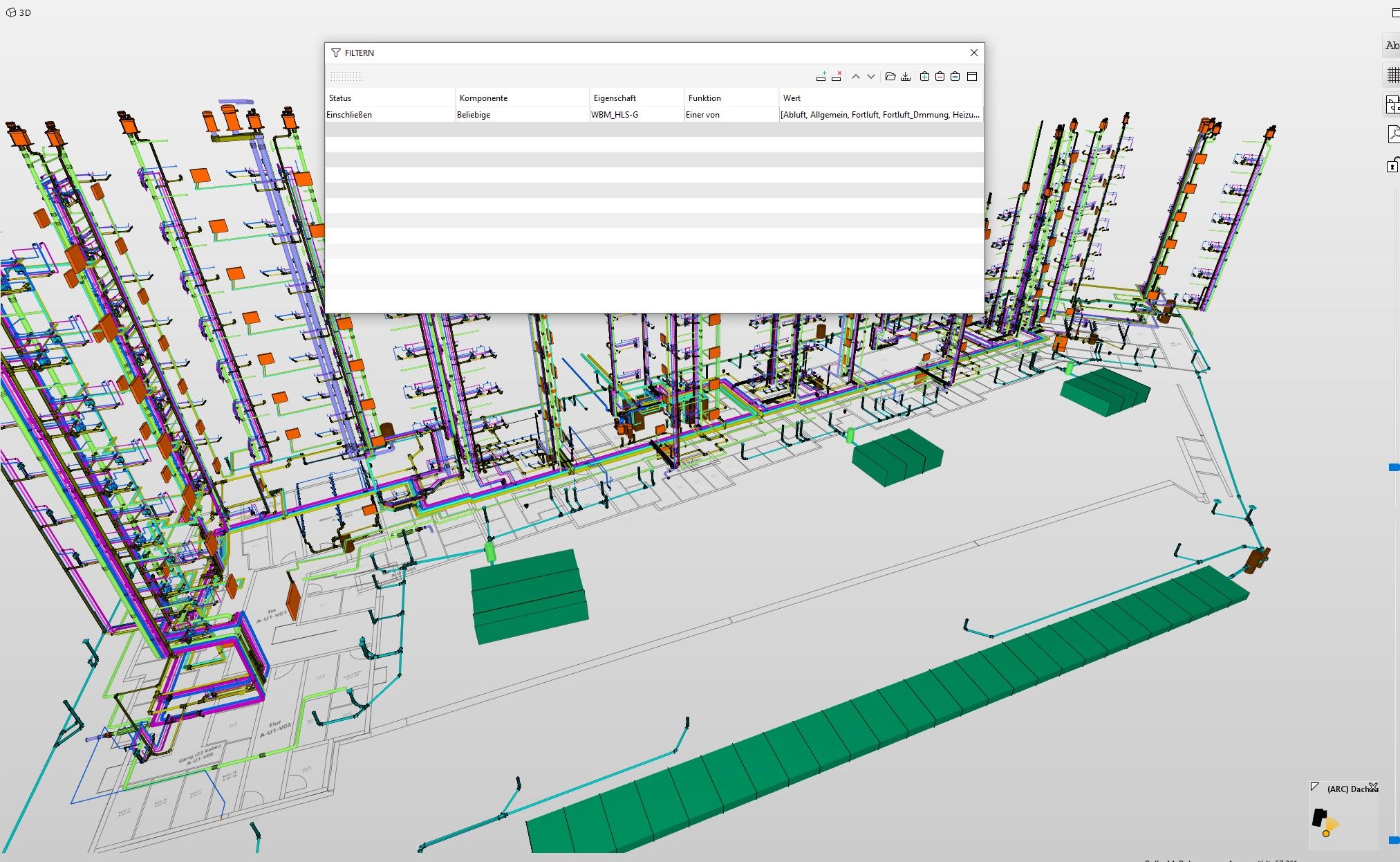

    I want to filter by multiple classifications that I created, but it does not work.
    As you can see, each classification works by itself, but not when I want to filter both at the same time.
    Then simply nothing is added to my selection basket when I select the equal sign.
    The classifications by themselves point to different models. But everything is set correctly, otherwise I wouldn’t be able to select each classification by itself, I think.
    Thank you very much for reading my message.
    I will be very grateful for any kind of help,
    Best wishes,
    Oliver

              If you are using the Any value for both lines then components can’t be classified in both as stated the two lines with the same Solibri Component will behave as an And not a Or operator. What you can do if the Classifications are not too large is to create an additional single classification which classifies these values into one classification, you can then use the single line in the filter that accesses this new classification.
