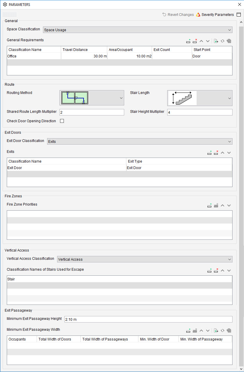

    What is difference between minimum and total width of doors.
    How should find total

        This information is something that you’d feed in as parameters. When you sum the widths doors of a space, that should be more than Total Width of Doors. For example, if you have an auditorium that can have 500 occupants, it should have at least that much door width when they’re summed together. Each individual door then should be at least as wide as the minimum width.
