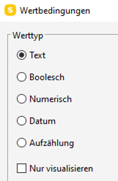

    We have been able to perform checks using Solibri, such as utilizing the “203 Required Property Sets” rule, which allows us to control the common informatic datatyps (STRING, NUMBER, BOOLEAN, DATE) of the data. Nevertheless, we are facing a challenge in verifying the adherence to the specific Ifc-Datatyps, as illustrated in the attached image.

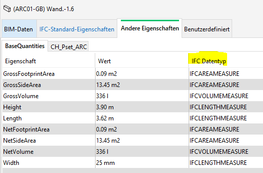

    Solibri can show this ifc Datatyps:
    Possible verification datatyps in Rule 203:
