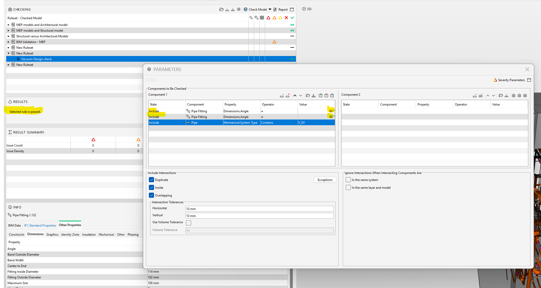

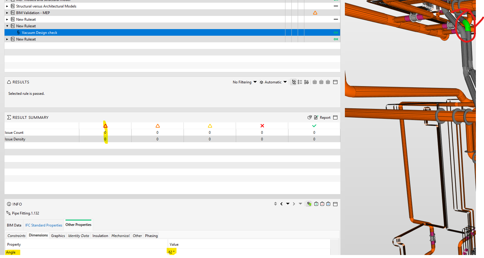

    Hi i am new to solibri.I want to set a new rule for design validation to show issues if the angle for the pipe fitting does not use 45degree or 90 degree elbow.
    i have created new Rule using Rule set Manager. But when i run the test it shows as selected rule has been passed. But still i have elbow with different angle present in the model. I have attached the images for you reference. Elbow 45-1.png Elbow 45-2.png .It would be great if i greet a a anger for this.

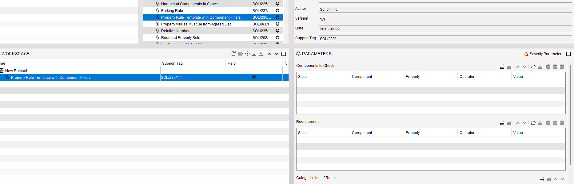

      @vigneshraj Please use rule 230 (Property Rule Template with Component Filters). It should give you what you want.
